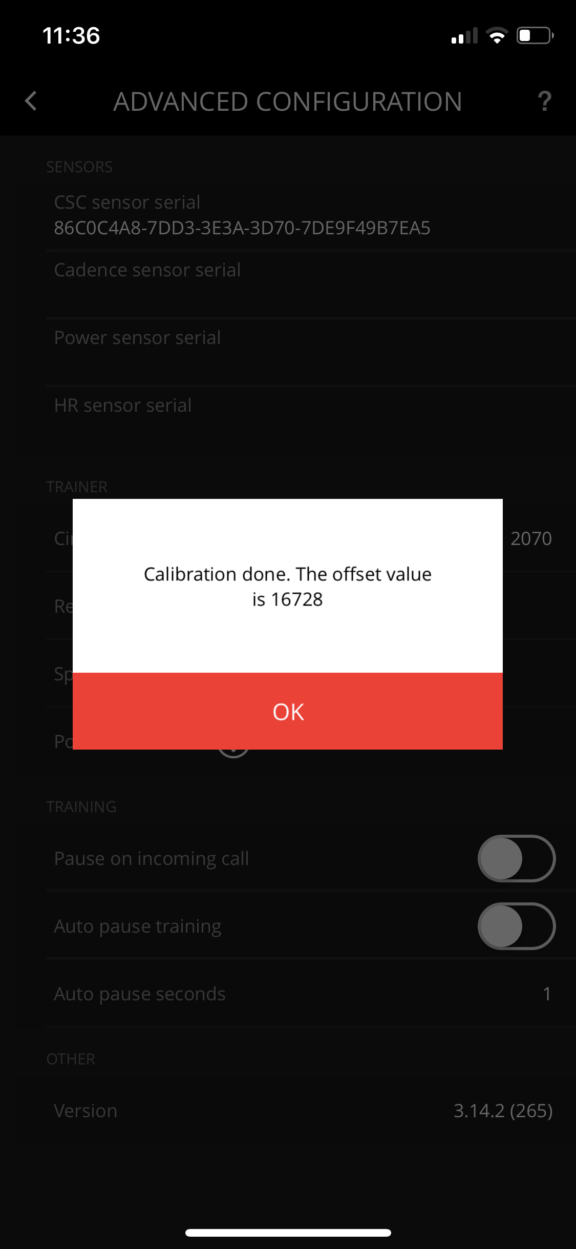

After spotting the “advanced configuration” in small writing at the bottom I got two calibrations done with that - any idea if these values are reasonable?
