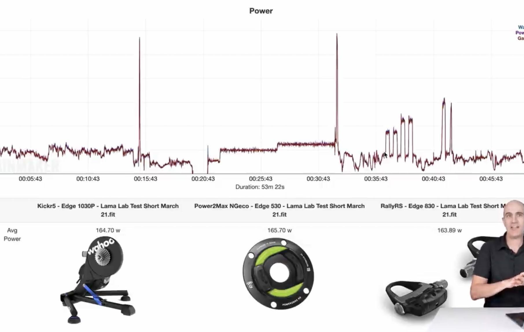

Here’s an example of three devices that are getting it “right”
From the @gpl Rally pedals video. My experience has my Rally pedals (XC200) about 6-11% lower than my Kickr and my NGeco (and Sigeyi AXO). This is with lots of test runs, updated firmware, temperature stability, etc.
I could find a similar screenshot for the Neo, but my Neo 2T is also significantly lower than my Assioma pedals (which match my Kickr, NGeco and AXO nicely).
Not to pick on Garmin or Tacx specifically, that was just my experience with lots of testing on my devices. Plenty of reports out there of Kickrs that run low or high, people buying multiple trainers until they get one that runs high for Zwift racing, etc. So, it’s a lottery when it comes to accuracy but I trust the tried and true companies like Favero and Power2Max more than I do the trainer companies. They’ll get there eventually but no surprise it’s taking time.
