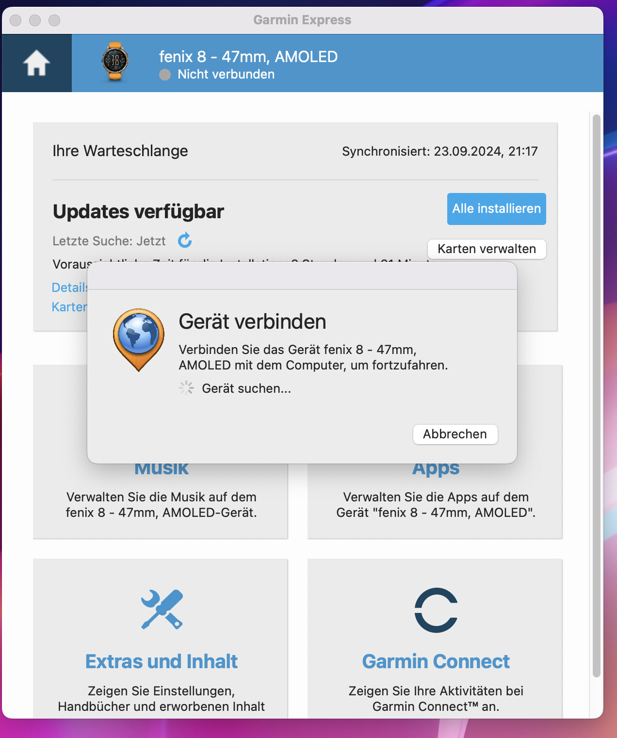

FWIW, I have problemes with Garmin Express on a M3 Max MBP as well. My Garmin Devices never connect (anymore?). Garmin Express tells me there are updates, I plug my Devices in, and it spins at “Connecting Device” forever. That’s with an Edge 840 and a Fenix 8. I have Rosetta installed. Not sure if these are the same problems as the OP has, but I too get the impression that Garmin Express on the Mac is quite lacking.
As you can see in my screenshot, it seems to have worked in september at least once though.
