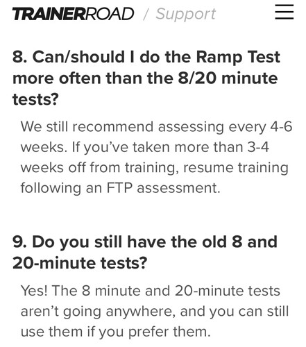

There is no requirement to perform a Ramp Test. You can use any of the TR tests (1x20m or 2x8m) or just manually edit your FTP as desired.
No. The purpose of the ramp test is to estimate your FTP.
From the FAQ:
