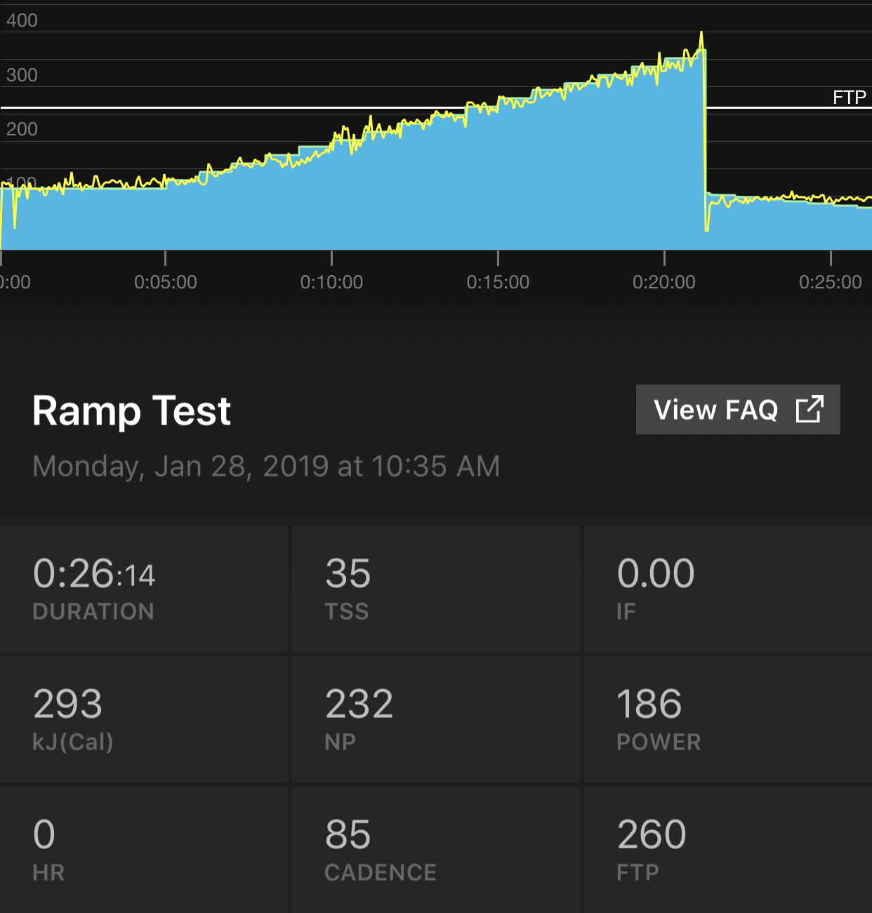

what’s odd for me personally, is that I have 6 good ramp tests that appear to give reasonable ftp estimates. And then 2 ramp tests in the last 6 weeks that have been complete failures:
  • Sunday Dec 9 did a group ride with PD curve showing 20 min effort at 233W - that was a hard push and not full effort. Felt really good that day and Monday the 10th.
  • Ramp Test on Tuesday Dec 11 gave me an estimate of 188W, it was as if I just ran out of oxygen and couldn’t breath anymore. At the time I theorized lack of recovery from the Sunday group ride. Kept ftp at 240 from ramp test 6 weeks prior
  • Wed Dec 12 struggled with Ebbetts (4x8 @ 88-94%)
  • Sat Dec 15 no problems with Donner which is 3x12 minute @ 95-99%
  • Dec 17 manually bumped ftp to 245W
  • Dec 19 did first 3 intervals of Kaweah another 95-99% threshold workout at new ftp of 245 and then stopped because of the dog (the next day we euthanized the dog)
  • flu bug late on Dec 20 and hung around for 4 weeks. I did workout a few times and nailed Bluebell and Jepson, while struggling on threshold and over/under due to shortness of breath
  • another sub 200 ramp test on Mon January 28
Weird. Ramp test worked for most of 2018, then failed in Dec and again this week.
There is a lot going on here, and I’m not sure the ramp test is to blame. Are you using the same power meter indoors and out? A ramp test result of 188W on Dec 11th means your highest 1min power was ~250W, yet two days prior you did 233W for 20 minutes during a ride without pushing? I would look at improving your cooling when riding indoors, because it doesn’t matter what type of FTP test you did that day, there was something going on to limit your power output considerably. Your next test was low too, but that was after struggling through workouts and a month of illness. I wouldn’t be so quick to blame the ramp test, but instead look at 1) eating enough carbs, 2) getting healthy, 3) making sure you’re not drenched in sweat when riding indoors, 4) not doing too much TSS.
yeah not blaming the ramp test but like I said, starting to prefer the 8-min test for other reasons. Food and macros are fine. Cooling is fine. Stages PM and TR’s PowerMatch for one source of power truth both inside and out. Which leaves physical health and stress.
So now blame game starts looking more closely at my TR calendar, starting with travel Nov 9-11 and great ride on the central coast (!) but too much driving (for me), and then poor air quality from Camp Fire the week of Nov 12 , then only 3 days doing TR the week of Nov 19 because of Thanksgiving travel, and then two 6+ hour driving days (Mon and Wed) for work the week of Nov 26 and seeing notes of “heavy fatigue” in my calendar. Key point - I don’t travel well. Followed by 4 days air travel the week of Dec 3. Which bring us to the fun group ride on Dec 9, followed by failed ramp test on Dec 11.
Think I see the smoking gun now… Nov/Dec didn’t do me any favors. First week of January started with almost 7 hours training, followed by 4+ hour weeks due to work. Hopefully the New Year crunch is over and I’ll fall back into a groove and can ramp up my training again.
