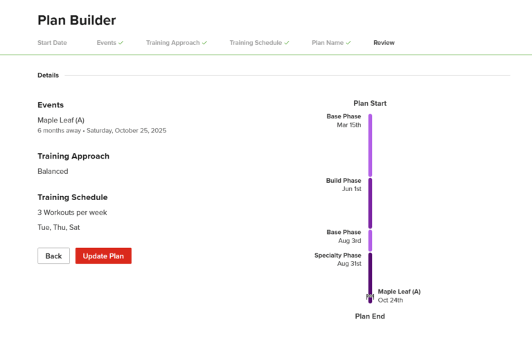

Also I’m starting to thinking about next season and have some ATP, but unfortunately TR doesn’t have such a tool.
Hey @Damian_Poplawski :slight_smile: There are some great responses here already!
TR’s approach includes Classical Periodization & Supercompensation to help you effectively build fitness and achieve your cycling goals. We target specific power zones and energy systems to maximize your performance gains instead of focusing on TSS. But as @SugaryRideAdventure mentioned, as you start completing your scheduled workouts the plan will start adjusting.
Here is more info:
