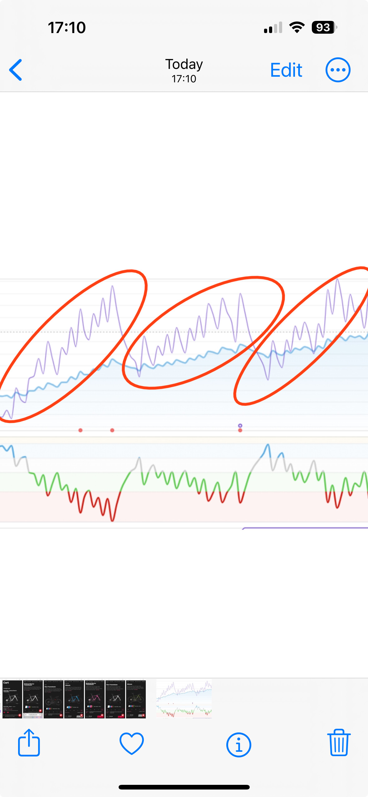

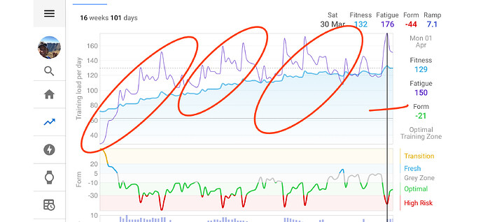

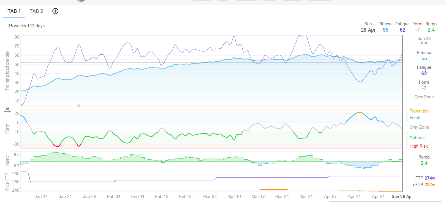

I’m curious to know what training you do to get your weekly profile, as circled. Or what settings you using to show your weekly training. Looks like a perfect ramp up.
I ask, my profile, the circled sections are three weeks each unlike your one week each. The large spikes at end of each week is usually a 6-8 hour ride with a sudden drop off as Sundays are off bike/feet up days.
I’m pushing between 18-22 hours weekly with rest weeks around the 12 hours.
Yeah, I’ve been pretty consistent for the last few blocks and watching my stress balance pretty close. I retired last year, so this year is really the first time I’ve had the ability to do decent hours during the week. I’m generally riding long (5+ hours) on Tues, Thurs, Saturday and then short endurance/easy filler days between them. 2 of those long days will typically include an hour or so of structured intervals/intensity. The view I’m looking at is just the standard 180 day view in intervals.icu, but I had just clipped out the last few blocks. Here is the full view, not quite as smooth. I started a decent/easy ramp in December, but had an injury in mid Jan that derailed me for a while, but have been super consistent since then.
