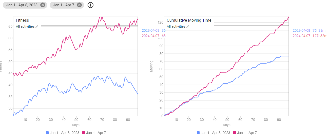

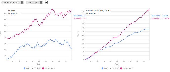

Here’s a graph of Fitness and Cumulative Moving time from intervals.icu, this year vs. last year. Intervals also has me at 294 eFTP vs. 258 eFTP this time last year, although the max effort last year was pretty iffy.
