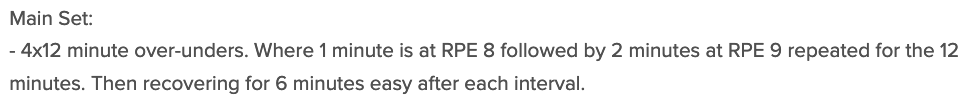

How about the TR over-under workouts that are classed as threshold? They can easily push you into 9-10 RPE.
RPE of 9-10 should not be overall feeling but per peak. For example, description from McAdie +2 (95% U / 105% O)
I.e. RPE is moment-to-moment feeling, just like power.
Only the stupidly stupid ones doing dumb stuff like 98%/115% :smile:
I tend to do o/u at 90%/110% and even pushing those out to, say, 3 × 18 I’ve never really got near a 9.
And if I did I’d pull the plug because the stimulus to fatigue ratio is too low at that point.
