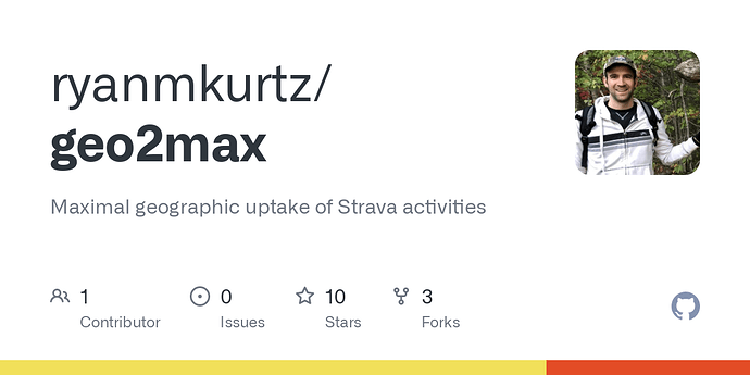

I created an open source Strava app that let’s you see your activities on a 3D globe. The activities table is pretty useful too.

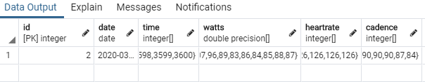

my “product” continues to evolve. The big thing is that I finally merged the handling of fit files and strava downloads into a central database, until today I had them being handled differently as I was learning how to work with these data and was finally able to marry them into the Django database (using postgres and storing each data stream as an arrayfield)

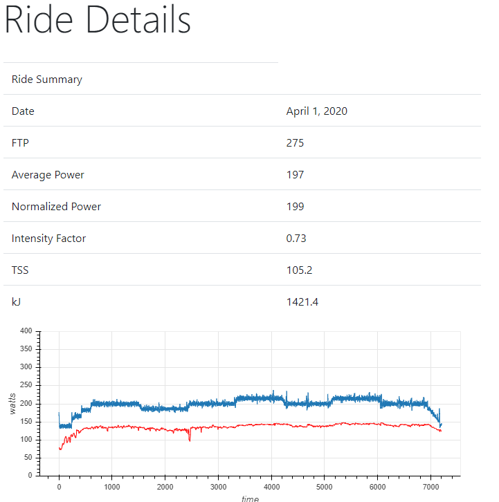

And just because visuals are always fun, just continuing to build my ride detail page with more summary stats. I’ll have to figure out how to get this onto a real server and see how it’ll handle additional users

  • Storing large arrays in relational databases is generally not a great idea. You’ll run into performance issues pretty quickly I would expect. It might be better to store the time series somewhere else (e.g. in object storage, like Amazon S3, if you’re deploying it) and only storing a reference to it in Postgres alongside the workout summary stats (TSS, duration, etc.)

Thanks! Will do have to look into these (although point 2 is still largely Greek to me lol) , right now my DB looks like this for my ridedata
Before I did this, I was just parsing the fitfile that was saved for the detailview, so maybe even less good performance-wise lol

:grinning: So what you could have is a database field with a file location, where the file (e.g. a JSON file) contains the time-eries data( time, watts, heart rate, and cadence in this case). You then load the file as required. Thinking more about it I’m not sure whether this would be better. Anyway, I wouldn’t about it for the moment!

You could use smallint arrays for a lot of those fields and save a bunch of space. Intervals.icu stores each individual trace on the filesystem in a csv.gz file. This is important for performance in that it keeps the activity table sizes small for fast query.
Also the traces are on spinning disks with the SSDs used for the database.
You need to think about backups and the database will get very big very quickly if you store the traces in it. The traces don’t change often but the db does so you can backup the traces much less frequently.

Also a data scientist & working in Python. I’ve only skimmed through the thread and don’t have any experience with relational databases but I do have some with large arrays. As @occasionalathlete says, there are better ways. Look into hdf5. Easy to store and load. Probably all fit files should be converted into hdf5 files on import.
