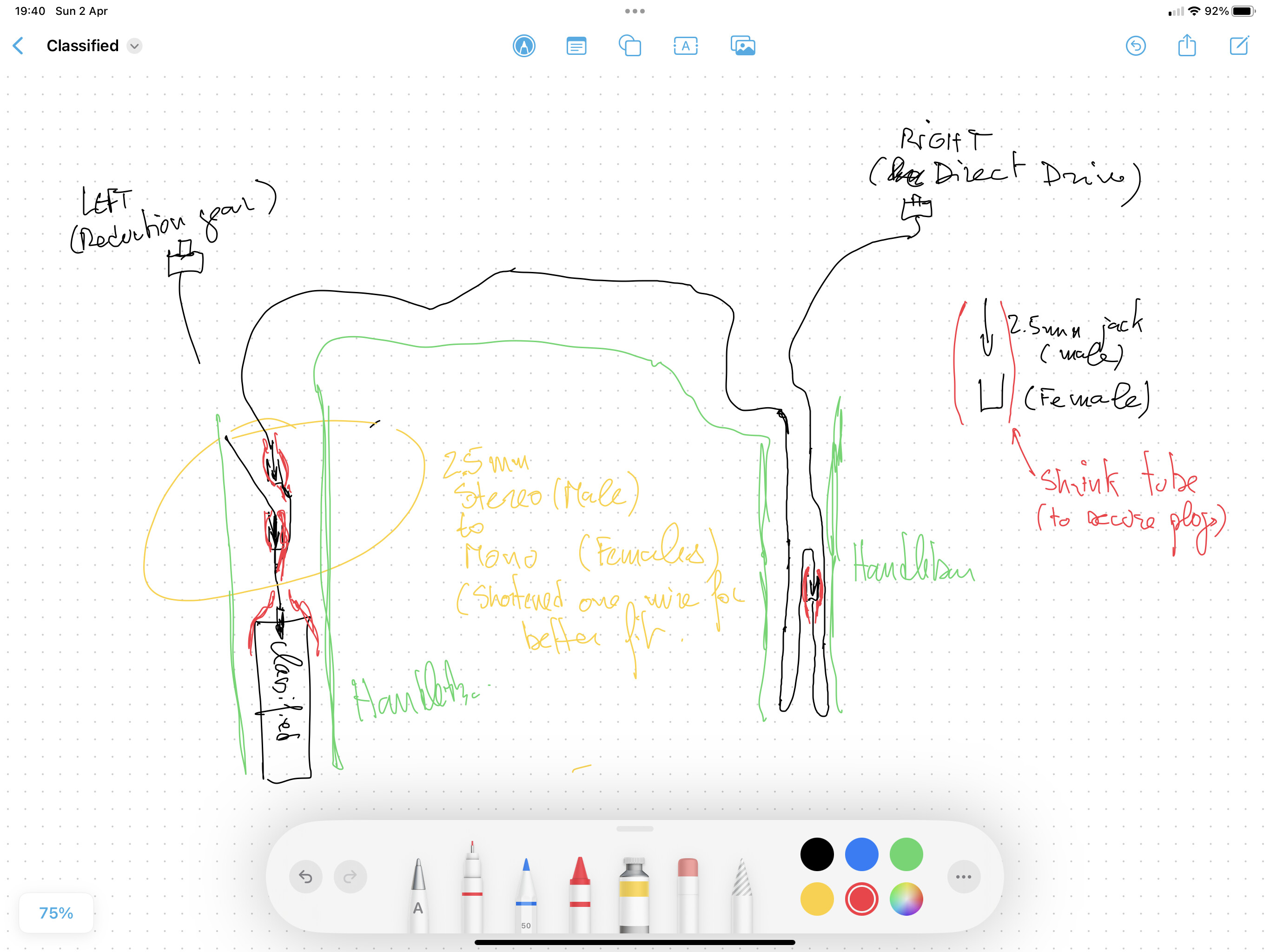

One can use 2 shifter buttons with “set” mode, by connecting them to the bar end module with a stereo to mono splitter, e.g. this
2m is very long, so I am just going to modify a regular 2.5mm stereo splitter to be mono, to keep cable lengths reasonable (and making jamming it all in the bars easier).

I ended up doing this, and love the setup. Much better than the original, at insignificant cost.
(Don’t forget to test every step)
Material involved:
  1. Classified module (comes with the system)
  2. 2 classified shifter buttons (one comes with the system, purchased an extra)
  3. 2.5mm jack stereo (male) to mono (females) splitter. Shortened one of the mono leads so that both can fit in-line in the bar.
  4. 2.5mm jack cable (enough to go through the handlebars, plus 5cm on each side. You do not want too much extra as it’s too hard to fit back though bars, and might cause problems when removing. Guess how I came to that conclusion. I shortened mine by cutting, soldering, shirink tubing to get something neat).
    The button cable length is not enough, and given the work involved in threading cable (especially a jack plug) through the bars, I’d rather do it once with the extender, so that if I have to replace the button, I won’t have to thread through the bars again.
  5. Shrink tubing, to secure the plugs (and in the likely case you shorten the extension cable)
  6. Bar tape (you’ll have to replace the right side, when adding the button)
Tools
  1. Cable routing tool, for the jack (I wasn’t able to thread it without)
  2. Shrink tube + heat gun (or hairdryer - much slower though)
  3. Soldering stuff (in the likely case you shorten the cable)
Rough steps
  1. Test: Plug everything and see which shifter drives the reduction gear, and which marks the direct drive, before installing the shifter button.
  2. Thread the extension table though.
  3. Insert shrink tube before plugging cables to splitter / extension / classified module.
  4. Plug everything .
  5. Test, making sure the buttons select the correct gears.
  6. Shrink the shrink tube around the plugs.
  7. Push everything into the handlebars.
  8. Test again that both buttons work.
  9. Close up.
Here is a diagram of what it looks like
