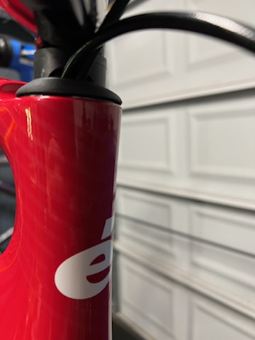

If you already have some bars you prefer, and which are lighter than the Cervelo bar, I have a bit of a “hack” solution that I put together yesterday for “semi-internal” routing of cables. I’ll shoot some photos when I get home and post them. This solution will completely avoid the necessity for any sort of proprietary bar/stem combo, and will allow the swapping of stems for fit purposes without cutting brake hoses.
Spoiler alert, think about the Cal 5 if it had a system similar to the SL7 or Trek Emonda in their current iterations. Pretty sure Cervelo would frown on this solution, but it took maybe 15 minutes of time, a Dremel tool, and a standard 10mm carbon, round headset spacer.

I will send pics when I am able. I haven’t altered any Cervelo proprietary parts or spacers reflected in the link you posted. I still use the full Cervelo headsest and 7mm top cap. I altered/dremeled a regular round 1 1/8" spacer a bit to allow the cables to exit the front cable “groove” of the Cervelo top cap without being “pinched” by the round spacer directly on top of the top cap. My hack will result in you using all normal, round spacers above the Cervelo top cap. If you didn’t dremel the first round spacer that sits directly above the top cap, and attempted to use an unaltered round spacer over the top cap, it will “pinch” the hoses, as there is not quite enough room for the hoses to exit between the top cap groove and the spacer.
Maybe not the best pics. But, here is what I’ve come up with as a potential hack for semi-internal cable routing. Definitely took more off the spacer than needed for this test run, both height-wise and width-wise. I’ll probably get another 10mm spacer and take less off of it so there would be less “daylight” around the cables. Twisted the stem off center in a few photos so you could get a better view of how the cables come out of the headset top cap.

Thats a CF spacer? I’m not sure about that, you’ve just ‘cut the string’ on the support keeping that spacer from spreading. You’d be better off hollowing out the standard dust cap running the round spacers to the top bearing and wearing the top cap as a skirt. I’d use alloy spacers too, as they are a touch narrower and will blend with the zipp stem nicely.
EDIT: I just looked, you need the spacer port here…
