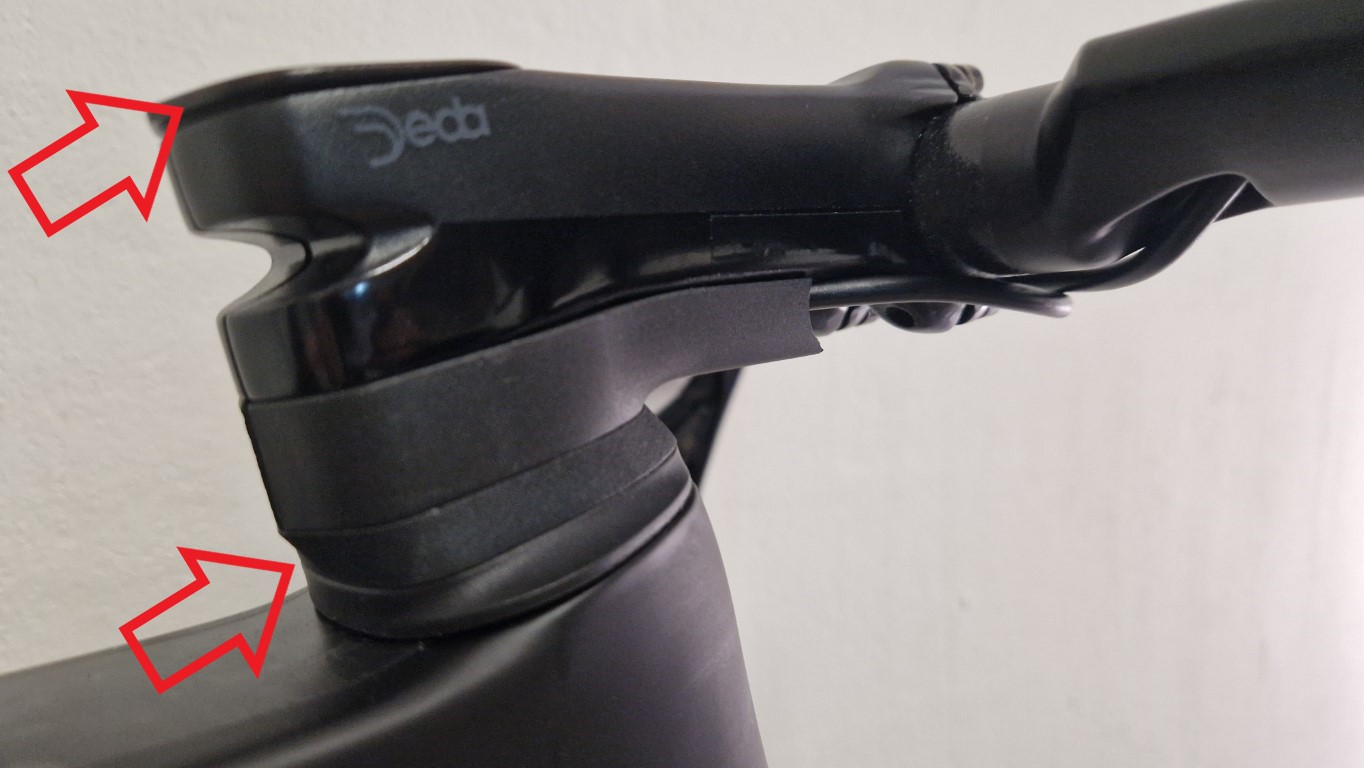

To install a Superbox stem, did you also need order a different top cap and inserts from Cannondale to get the headset compression correct in addition to the Deda Alanera/Superbox bearing cover when moving from a Conceal stem? I’m starting to make a list of everything needed to swap over and it seems to go from a Conceal stem, the top cap needs to change too.
my understanding is that the inserts to fill in the space you for the new stem will be the same ones as used for the conceal stem. the ‘top cap’ will come with the deda parts but you will need the ‘top cover’ specific to the frame from deda. there is a good bit of weightweenies discussion about it iirc.
disclaimer: I don’t have any first hand experience with this, i’ve just been researching my own potential projects.
The Deda bearing cover comes with a new top cap that works with the stem and the Delta fork using the original Conceal compression screw.

Blockquote georgel
Thanks for the confirmation. Nice to know it will be one less part to order. Do you by chance have a picture of how the set up looks with the Deda top cap?
Readily available picture.
Imagine the Deda top cap with a larger hole to acomodate the Cannondale compression bolt.
Mindless modification: I had put in two steel inserts into the Cannondale stem inserts as to (magnetically) pull these up. They slip down ~5mm. May design/print an insert that keeps them at the right level.
Yes, picture is bad. I should have pointed this out.
The wedges should be level with the top of the fork since the top cap will protrude ~1-2mm into the stem opening.
The Deda stem uses the Deda top cap with a sufficiently large opening for the Cannondale bolt.

Custom Garmin mount proto with brake cable guide. Semi integrated for easy packing:
Red arrows = the Deda adaptor shim for the 2023 EVO + the supplied top cap:
Appreciate the photos! That really helps. Looks like you can still run some spacers above the stem to get the correct preload. That was my main concern with running the conceal stem and having to cut the fork right away. I might be wrong on that. In terms of the slipping down, I guess that this spacer might still be necessary to keep them from slipping down?
Well, that’s the thing… it won’twork for me. That spacer blocks the cables from running “in the delta”.
And a second thought:
I assume it will require a very different spacer on top, should you want to not cut the fork immediately. All since the “delta star nut” protrudes from the top of the steerer.
