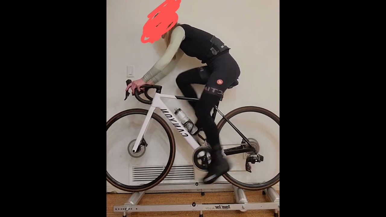

Before you pay for a bike fit, film yourself on the trainer, and also on the rollers. That might already show up some issues.

I think this is a great point…film yourself and post it here. A lot of experienced eyes can likely help sort some things out.

I’ll work on the videos. I got a reasonable one on the rollers, but… uh… not clothed as I’d prefer to post online.
These are teammates who don’t want me wasting watts on bad form. I am confident that if I were all over the place or engaged in other bad behavior, they would tell me. I’m decent on the rollers, or at least I was 7 years ago when they were all I had. They just haven’t been the best option since my high-energy kid got big enough to knock me off them.
As for keeping the cadence down, that’s what I tried last time. My ride record shows very few spikes above 95 (over 4.5 hours or so) and I was told I was still bouncing.
Hard to tell what’s the issue without seeing any video.
Most of the saddle related “bouncing” is becouse of too high saddle. Lowering it just by a couple of mms can make a huge difference without any real downsides. That’s what I’d try first but it could of course be totally wrong, only you can tell.
What came to mind also, is that it could be something totally unrelated to bike fit. One of my teammates has this weird “twitchy” kind of pedal stroke which, I guess, is just his way of pedaling the bike. Kind of like we all have our own style of walking.
If you’re not comfortable posting them online, don’t. I meant more to film yourself so you can see if you’re actually bouncing. But if you do want to post then, there’s lots of experienced people here that might be able to help.

Uplodaing this one, Myvelofit now says that I’m within range on everything (I haven’t changed anything) :face_with_raised_eyebrow:
I was told at this week’s crit practice that I seem to be bouncing less or not at all (since raising the saddle ~4-5mm). Will see what happens at the group ride in the morning.
