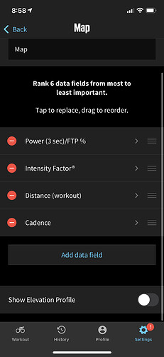

Are you sure that you don’t just need to scroll down or delete data fields? I didn’t see the profile option when I checked in setting for my Elemnt. So I tried deleting data fields to see if it would show up. That moved the option further up and now I could see it.
However, I am not sure that it doesn’t turn off the profile option if you have too many data fields selected. At some point it just had no room left.
Admittedly, it could be that they no longer offer it on the BOLT, but I would try the above first, since I haven’t seen anyone else mention this change

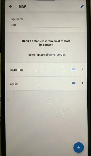

In my Android app (latest update) this option is not there… as you can see I dont have many datafields active.
Could you please post a screenshot of your page? Thx!
Below is my screen (iOS).
I would try deleting both of those data fields to see if the profile option reappears.
If not, I still wouldn’t conclude that this was a purposeful removal. It could be a bug in the phone app or the device app.
Removed the fields, not there. Ok, will try it on my iphone too.
Nope, IPhone/Companion App does also not offer me this option anymore. It is definitely gone.
