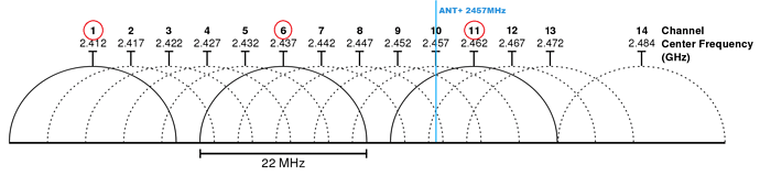

The 2.4GHz band is a bit of a wasteland, as mentioned, so number one thing is to not use 2.4GHz for wifi, and use 5GHz instead. If you do need to use 2.4GHz, use either channel 1 or 6, since 11 (really anything between 8 and 12) overlaps with the specific frequency that ANT+ uses:
This was a factor for me when I used to stream (or at least tried to!) stream music through my phone to wired headphones. Changed the channel, and problem (mostly) went away. Using a USB extension cable so that the ANT+ dongle could be physically closer to the power meter also helped.
Bluetooth is a bit different, and uses frequency hopping so there’s less that you can do besides using the same USB extension cable idea as above, so that the signal you want your computer to hear is the closest to the antenna, and strongest.
