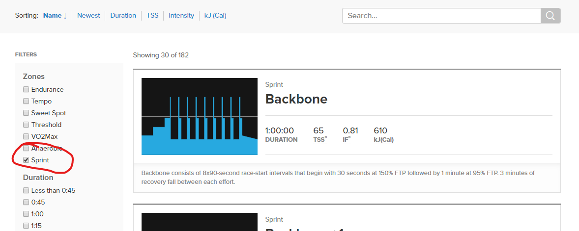

Don’t use Erg?
You can filter to find “Sprint” workouts:
