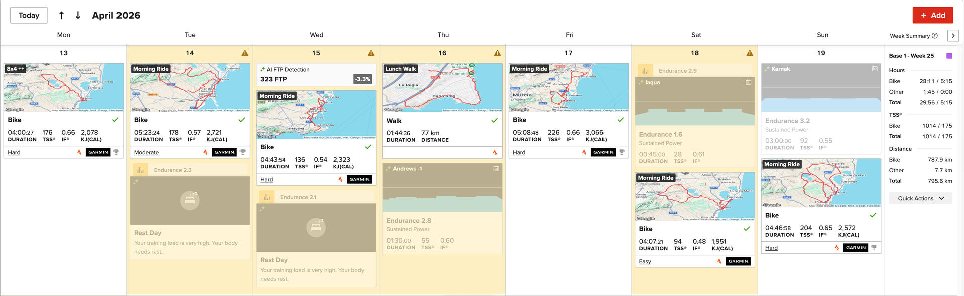

From the screenshot you posted I see that none of your workouts have the sparkle on them, except the last two. The sparkles normally indicate that the AI is picking them. When there is no sparkle but with the Calendar logo, this indicates that you chose an alternate…Did you edit the plan in any way?

I haven’t edited any of the workouts, but did remove a B-race that was canceled. So the plan has been recently updated.
@Caro.Gomez-Villafane The missing sparkle seems to be a bug that appears when I add a race to my calendar. Adding a race switches most of the workouts to too easy workouts (compared to a reasonable progress to reach my predicted AIFTP) and thus the sparkle disappears. It fixes itself at the end of the day when TR runs a end of day refresh, but adding another race gives the same problem again. The predicted difficulty for the workouts on my calendar also disappears with this bug.

As far as the Prediction estimating a big jump, is probably because it’s assuming you will complete all the prescribed workouts left within the block, as opposed to last block where there wasn’t much adherence to the plan.
However, it will be interesting to see what you get on detection day, as I see you’re not really following the plan on the Specialty Phase either. Completing a lot of unstructured big rides does affect the prediction as the whole is being considered towards your FTP, so while you may be in a Specialty Phase, the unstructured riding + the schedule workouts you do will be what determine your detected FTP. Right now, the prediction is the accumulation of the whole: what you’ve done and expected to complete in the next 2 weeks.

By looking at the last block and this one I would not consider the following a good plan adherence, nor just skipping Saturday’s threshold workout.
Last block:
Few things about this block:
  • Balanced approach
  • Ski days + lots of unstructured riding taking over scheduled TR Endurance/Interval Workout
  • Workouts being manually picked or choosing a Workout Alternate/AI Workouts (this you can see if it’s missing the Calendar or Sparkle or both in the workout card).
  • All except one interval workout (March 24th) were rated Hard which is what we want to interval workout to feel like 9if rating honestly). Note: The Maximum Effort on the 24th did come after a full weekend of skiing, which of course has a toll on your legs.

  • Logged in pretty big 4-5 hour rides the first week (April 15th-19th) and then got sick.
  • Changed your training approach to Demanding and did a race right after getting sick
  • Overall I see a lot of big rides too even on days the system is telling you to rest
  • For the first 3 weeks I don’t see any type of plan adherence to the workouts being recommended.
  • Cowpen on May 2nd was your first TR Interval workout, but that one looks to be manually picked (no Sparkle or Calendar on workout card) and rated Very Hard on a Yellow Day.

I had no unstructured rides. The fact that TRs HrTSS estimation overestimates TSS for easy endurance to such an extent that it seems like I have done something else than what was planned is not on me.
Every single manually picked workout is me picking an easier alternative because what was scheduled would not be possible. Which makes it a bit wrong for you to take credit for the workouts being hard. They where hard because I chose workouts more aligned with my actual fitness. The SS workout I failed was also originally scheduled to be harder, and no, XC skiing for someone with ok technique isn’t any more taxing on the legs than a standard endurance ride, if anything it’s less.
