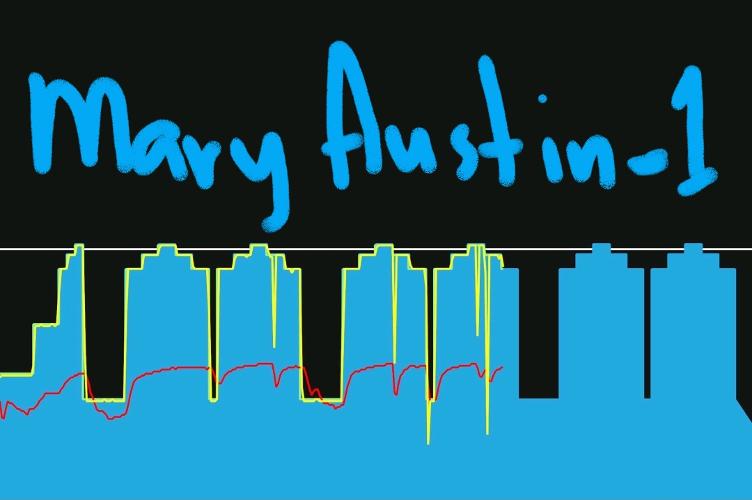

Been doing TR for over a year now and finish all workouts except over-unders, like Mary Austin -1.
I think I’m good at suffering but my legs just can’t turn the pedals any more.

I tried Mary Austin -1 3x until now. Twice I made it to the 5th interval without backpedalling, but now I had to backpedal already on the 3rd interval.
I got all new heartrate medals from strive.ai including riding at my max. heartrate for 4 minutes during today’s Mary Austin -1. Just to prove I was definitely putting in the effort :rofl:
My 2020 goal is to finish Mary Austin -1 without backpedalling.

What your workout history is telling you is that you lack a) muscular endurance and/or b) lactate capabilities. Believe me, lots of people are/have been in the exact same situation (including yours truly). Why do you think MA is one of the most complained about TR workouts!
FTP means nothing when doing MA (or any other workout, really). Work a lot on your lactate abilities (production and clearance) by doing more Threshold and O/U work, plus more longer Endurance rides. It will take a while but it will happen and you will complete MA.
What happened the night before you did you o/u workout? Did you sleep enough? Eat enough? Did you recover enough since your last workout?
O/Us are pretty intense and take a lot of muscular endurance to complete. Also, it’s kind of arbitrary that we pick the duration of the workouts. You completed 4/6 of the intervals. On the fourth you should have stopped trying for the remainder of that interval and then have ridden zone 1 before tackling the 5th interval. I bet you could have done it.
Personally I’ve failed a mid way interval, rested up a bit and then was able to complete the workout.
Also notice that ALL of your back-pedals are during the descending portion of the interval. This is a definite marker that your lactate clearing capabilities are not as developed as they could be. Lots of fun work in 2020 for you. :tired_face::wink:

Sure, proper fuelling will help you push the power, but from your posted example, that’s not your deleterious downfall — it’s clearly your body’s ability to shuttle lactate (which no amount of carbo loading is going to fix).
The back-pedals come on that first drop down when the lactate totally floods your quads…and they turn to jelly. You might try other O/U workouts with shorter intervals or shorter steps. Maybe create your own 2-week O/U Booster Plan which works up to the full MA.
(caveat: it takes longer than 2 weeks to develop strong lactate skillz but dedicated focus is a good place to start.)
