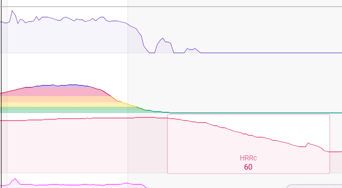

This is right after a 10 minutes ascent where I did high threshold-VO2 over/under’s
After the descent I had a second turn up and down, where my HRRc was 56, but not showed on the graphs.
Aye, it’ll only show your best HRRc from each activity. I’d argue it would be nice/interesting to see more than one, maybe let the user set a threshhold of “show any drop over XX% of the max drop of the activity”, or similar, with it defaulting to 50% or something.

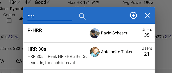

Yes that would be nice and has come up a few times. It will probably get done eventually. If you are enthusiastic you could code that as a custom interval field using Javascript (HRRc after each interval as a field on the interval). I did a quick search and someone has done something similar already:
Actually I might have done that one (that is my wife’s account).
Cheers
David
