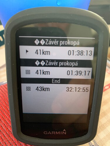

Anybody knows what Garmin data screen this is?
Hi,
whenever I am navigating this additional data screen turns up and shows some distances. How can I switch it off? I switched off segments, climbPro, elevation just to try if this screen gets eliminated.
No, whenever i set up navigation and choose a course it is there and is useless.
How to get rid of it?
Thank you
Ok, this seems to be the Garmin Segments Page.
Despite the fact that I switched off Segments, disabled all segments the page still pops up once I chose a course which includes Segments I starred.
Anybody an idea how to solve this without having to delete my Segments?

It is not segments, it is the options “course points” which needs to be switched off in all courses settings on the edge itself. a bit annoying but ok, so the link above was rigth!
