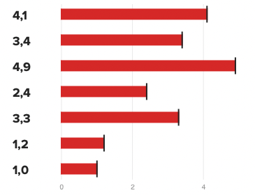

Sure! No reason to hide how much progress I have yet to make :wink:
I bought a bike computer in January (happy new year!) but did not get a power meter until late April (happy birthday to me!), so I imagine that 3-4 months of rides without power data might have something to do with how it was thrown off by so much.
That said, I’ve read enough “AT is trying to kill me” or “why are my work outs so easy” threads to imagine it would be useful to let people manually check their FTP every now and again if things feel “off.” If AI is doing it’s job, it won’t matter, but it might build confidence in AI if those who are suspicious of the robot apocalypse at least have the ability double check it if they feel they need to.
