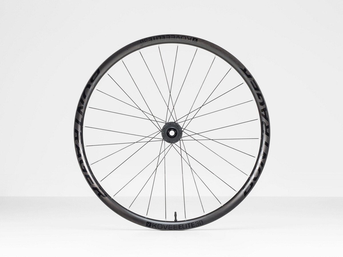

  1. Trek Kovee Elite 30 TLR wheels (no rider weight limit, 6 bolt hubs, 28 spokes, carbon)

  3. The Trek wheels have a great warranty, but 28 spokes even with no weight limit (I’m 6’5" and about 255 lbs right now). If they taco in the first 2 years, i can get a new wheel. On the other hand, the hand-built wheels don’t have a comparable warranty, but if well built I’d expect they’d be bombproof. Does one scenario seem preferable to another?
If you’re looking for a big improvement in performance for less than $1k, quality alloy is going to be the way to go. I actually think that high-quality alloy wheels are the way to go in general for most people off-road, but that’s another discussion. The key for you, being a bigger rider on less-than-smooth terrain is going to be build quality. For that reason I would stay away from Trek, Roval, etc. They have a good warranty, and based on the work I’ve done to those wheels out of the box you’ll likely need it.
Anyway, a retail recommendation:
Astral Outback - Astral does complete builds with a couple different hub specs, they’re all good but I would splurge for one of the White Industries versions. The rims are rock solid, and have some of the tighter tolerances I work with which makes for a more stable wheel over time. They’re also light, and in my experience take rock strikes quite well.
Ultimately my best recommendation is never to buy a wheel off the shelf, but to find a wheel builder near you and talk about options with them. When it comes to performance wheels, build quality is the ultimate determinant of longevity, and I do not trust major brands to do a sufficient job there. You also get more choices - any rim to any hub with any spokes, the solution is made for you and not a larger audience.
