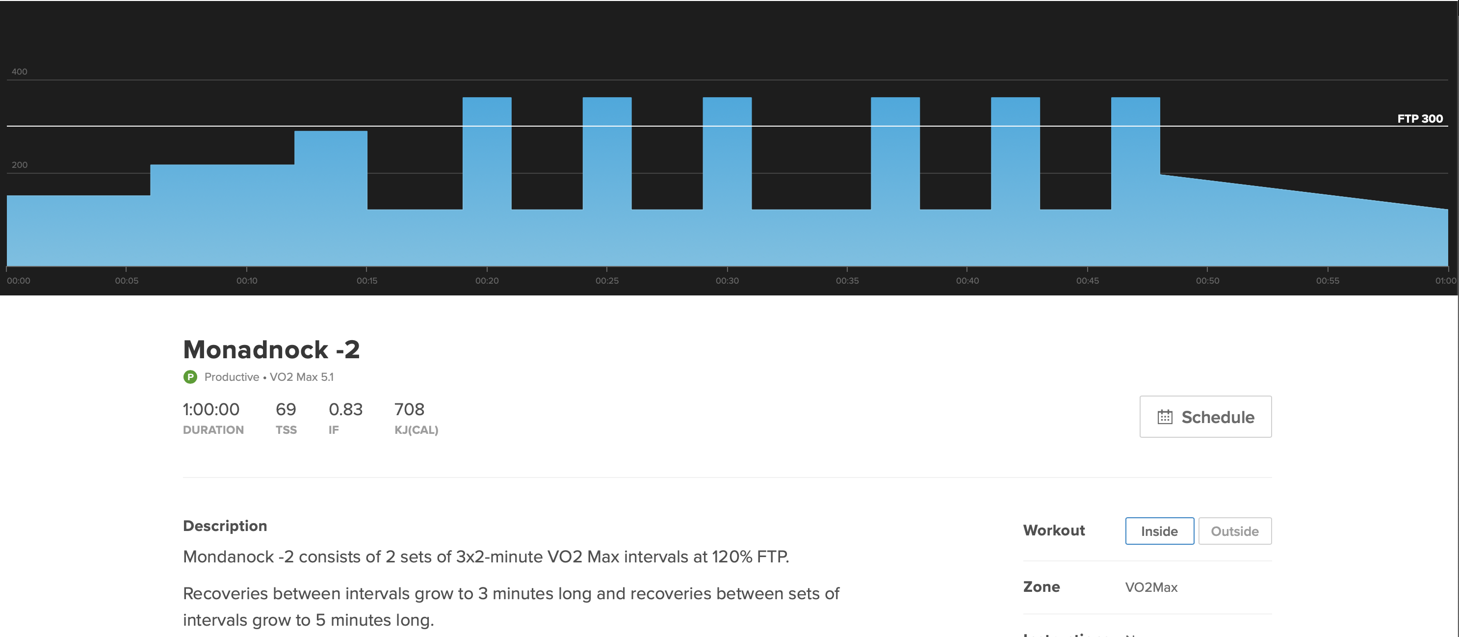

Odd thing I noticed with Workout Levels. Any explanation for the problem below?
Had Engeler scheduled, VO2 max 5.0. Six 2-min intervals @117%. With some zone 2 at the end.
Basically, I wanted a shorter version (~1 hour). There weren’t any alternates that were 1 hour in length that matched, and I’ve missed out on progressions in the past by cutting the workout early. So I created a custom version. Literally all I did was shorten the Z2 at the end, that’s it. But somehow, the workout got harder? VO2 max 5.3 (from 5.0). What? I shortened the workout but it got harder?
Then I found this workout. Monadnock -2, VO2 max 5.1. And this has six 2-min intervals @120%. So harder intervals, and even shorter rest, but still rated lower than my “custom” workout. Any ideas?
Seems like something you should contact support about.
The workouts in the catalog were graded by excluding the warmup/cooldown sections, and occasional further hand-tweaking where the TR team felt it was necessary. Custom workouts are computed on the entire thing. So in your case, the “shortened” cooldown looks like more work, because the original workout was graded as if it wasn’t there at all. Also, the warmup ramp was likely excluded in Engeler’s computation, but included in yours, so that appears as some extra threshold work.
I haven’t seen anything official about allowing custom workouts to mark the warmup/cooldown so PL calculations are more in line with the catalog (or allow hand-tweaking). I’m guessing that TR is hoping the fix is to throw the “random outdoor rides grading” algorithm at custom workouts, because those will have similar issues around warmups and cooldowns.
