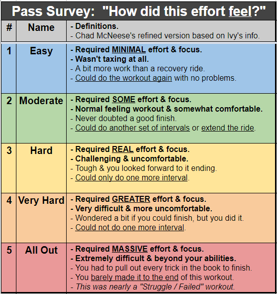

I’ve been following this thread fairly religiously and am really enjoying AT but I’m unclear on this as well. Specifically, for the post-ride survey, I’m trying to figure out how to respond on the spectrum of, let’s call it “objective difficulty vs. difficulty relative to expectations,” and how that influences the choices AT makes. This is most clear at the extreme end of the spectrum but actually gets a little more confusing somewhere in the middle.
Two examples:
Redondo +2: the only way this workout isn’t going to be brutal is if you’ve significantly underestimated your FTP. So assuming you complete the workout and are wrecked at the end how do you respond?
  1. Moderate - does this tell the machine that it’s what you expected, as in “moderate vs. expectations, not harder than what I expected” (so AT makes no changes; everything is on track) or would it mean “I expected a more difficult workout than it gave me, so it was only moderately difficult compared to what I was expecting?” (so upgrading the difficulty on some future workouts).
  2. Hard - this seems the most likely answer because it works on both fronts: you expected a hard workout and got one, and it also just kicked your ass. And I’m guessing this wouldn’t cause AT to make any adaptations, but just note that you worked hard and things seem on track.
  3. Very Hard - the flip side of Moderate - does this mean “I expected it to be hard but it was way too freaking hard” and cause AT to downgrade future works based on difficulty finishing the workout, or does it mean “I expected an ass-kicking and I got an ass-kicking” so everything is on track?
Lazy Mountain: this is a recovery ride, generally speaking, so do you mark it -
  1. Easy - You expected an easy workout and got one, so everything is on track and AT doesn’t make any changes. Or does it mean you expected something easy, but this way too easy, so future rest day recommendations will be scaled up a bit?
  2. Moderate - The opposite of Easy. “I expected a very easy workout, but this was moderately difficult so downgrade it next time.” or “I was expecting Easy, so this Moderate relative to my expectations. Everything is on track.”
So having written all that - can we get a little more clarity about what the survey responses actually mean and how they affect the choices AT makes? It might also be worthwhile to re-think the actual response options to make the impact of the choices a little more clear to the user. It could give AT users more of a feeling of agency and control, as opposed to plugging answers into a black box (which is pretty much what using Machine Learning is at this point, of course).
  • TR has said that “expectations” are NOT a part of the survey.
  • It is purely about how it “felt”.
See my file for the proper interpretation of what the survey responses mean, and how they should be used.
Here is the official post from TR, in the thread where we are discussing surveys.
Great, thanks for the link to the doc! (and I requested access) So the survey response is just part of the data set AT is using and doesn’t automatically determine an outcome by itself? I’ve been pretty happy with how AT is doing things, but I have to confess it’s driving me a little nuts not knowing at all what’s going on behind the scenes.
  • Covered in the email, but I keep my master sheet locked. I sent instructions on how to make your own copy from my sheet.
  • Correct. The survey response is only one piece of the puzzle.
  • We may learn some more about it all, but we will never have a full picture of the process for a number of reasons.
  • With the qualifier that a person is riding with an “accurate FTP”, and confirming that 0.96 IF is for a 60 minute workout, I think a Very Hard to All Out are quite likely and appropriate.
  • That is considering what that IF and Duration typically mean, and in light of the survey info TR shared, and I summarized as seen above.
It is definitely doing some learning of your usual responses behind the scenes.
My normal response with any of the “target” workouts (the ones on the hard days) has been to rank things 3-Hard based on Chad’s table, which I don’t think has ever led to adaptations. Then when I rank things 2 or 4 I have been getting adaptations harder or easier.
Other posters have reported that AT is giving them adaptations when they rank 3, which I haven’t seen so far (although I can see it might happen if I ranked a workout significantly below my PL as Hard), but they seem to be using the lower rankings a lot more than I do. AT seems to have learnt that and makes the adjustments based on your own response history rather than having a generic rule. I get the impression (maybe unjustified) that some users are ranking lower deliberately to try and get faster progress (I guess this is human nature…) but AT seems to have some limiters built in around this, otherwise ultracompetitive types would be ranking everything 1 and blowing themselves out within 3 weeks :smiley:
So I would suggest the key is to be consistent with your approach to rankings.
Also that workout looks miserable!
