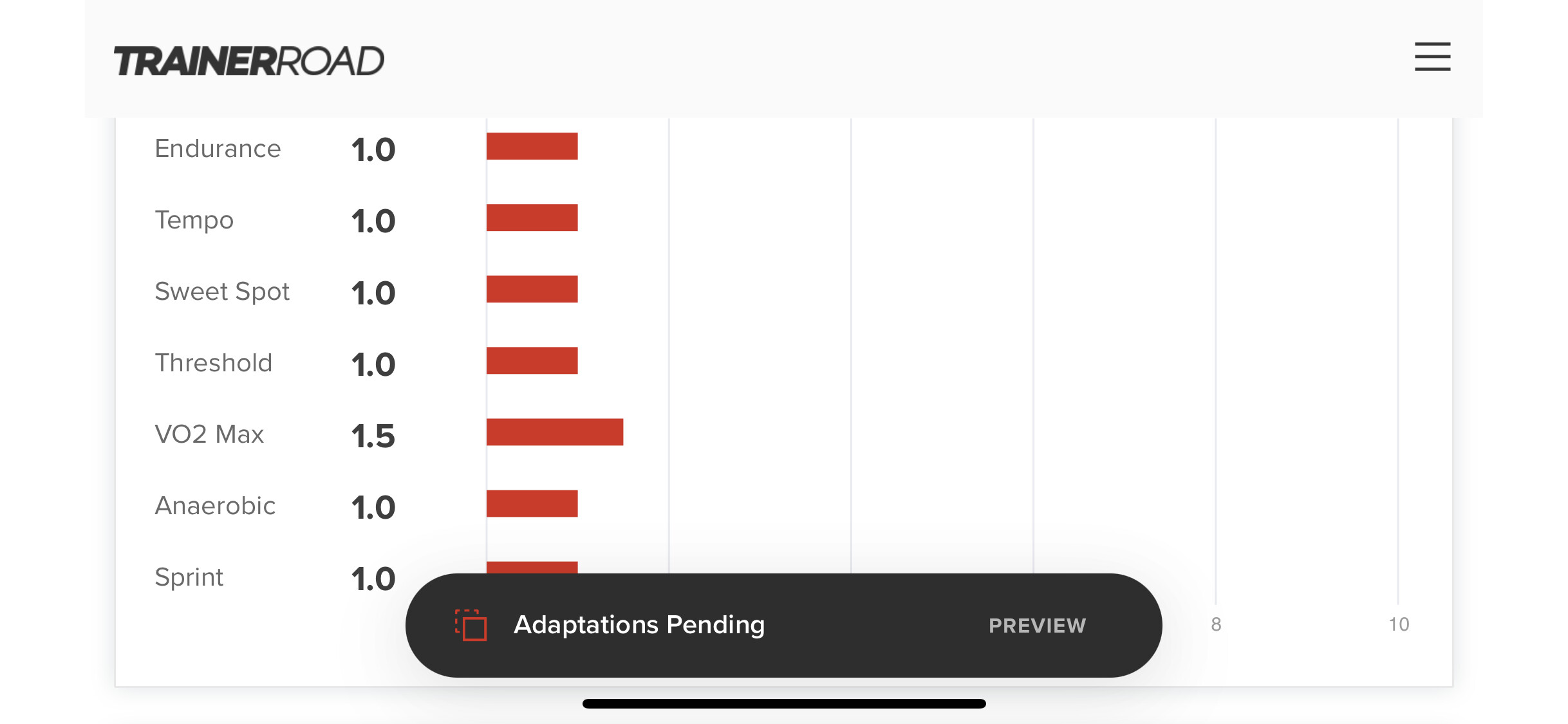

Just a query for the more ‘knowledgable’ people on this thread; is the following pretty normal for AT … ?
Just about to finish ‘General Build’ low volume and have really enjoyed it. It’s my first time trying general build as opposed to short power etc. Over the 8 weeks of work I have swapped out four of the longer weekend rides for higher TSS outdoor sessions (200k ride 9 days ago as an example) but have nailed all bar 1 workout (failed midway through last interval of a multiple interval threshold workout).
I’ve felt pretty good doing this programme - and put in my usual extra ‘rest’ period to account for being an older rider (coming up 50) who recognises recovery can be slower sometimes.
Anyway - I’ve noticed the AT Beta has bumped my levels up significantly on both VO2Max and Threshold (from around 5 on VO2Max to the numbers in the screen grab below by way of example).
My question is, is this normal?
I’m concerned that my next training block might end up being too challenging if my FTP is ‘bumped’ by the spike in shorter duration power, as historically I’ve found my endurance is my weakest attribute. I suspect I’m just second guessing the system and should just trust in the process but still have a nagging doubt the AT will start me off with a level I cannot cope with.
My next block (after a week’s holiday in Devon - definitely taking my bike :slight_smile: ) is going to be more ‘build’ as I have no event to focus on, via a speciality block and don’t fancy returning to base - so am thinking Sustained Power Build to target my endurance more.
I guess doing the ramp test again will re-baseline things, but I’m curious as to how the AT actually works in this scenario - I’m not a tech geek guy so admittedly struggle to wrap my head around how it is supposed to operate.
Any steer gratefully appreciated. :+1: :+1:
Are you saying AT bumped your PL for VO2 to 7.6 without you having done a workout that high?
My understanding is that the polarized plans are experimental, and not supported as a PB plan in AT. If that’s the case, then someone using a polarized plan, even in PB, would see PL changes, but would not see any adaptations to future workouts on the calendar.
I think that’s been stated somewhere in this long thread, but it would be helpful to have an update on polarized plans and AT would be helpful. @IvyAudrain or others from TR?
Good question. I’ve just been riding, following the workouts it gives me and have seen the numbers on the chart rise steadily. Today’s VO2 Max workout was as below (badged as a 7.6), the last VO2 Max one was badged as a 6.8. I have opened up the link and noticed (for the first time!) that it actually notes progression below the graphs. Doh !
