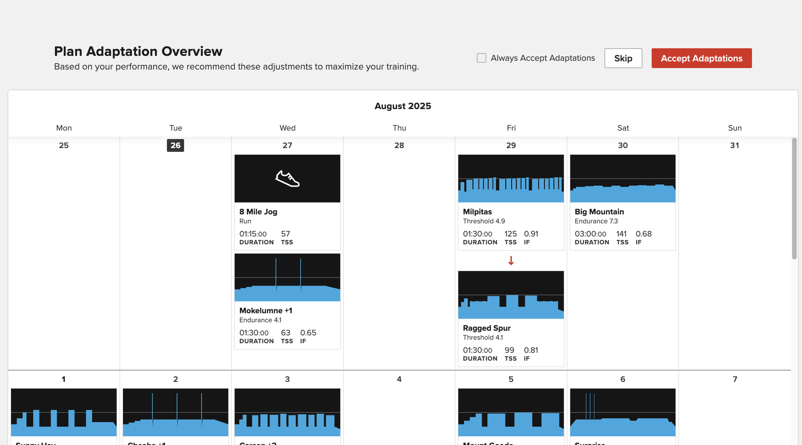

Just logged on to the site and it adapted my 2 next Sunday 2:00 endurance rides to lower PL.

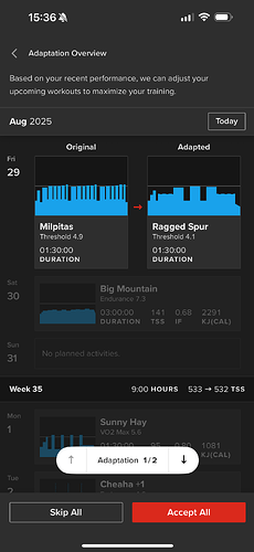

Lately I have finished workouts using the Windows app and got no adaptation recommendations. Later, on the website, I got recommendations and a subsequent yellow day. Adaptions were 4 and 6 weeks out and very small, only changing TSS by 1 point in one case, and only changing IF by 0.01 in another. Nothing wrong with these, just mighty tiny and relatively far out.

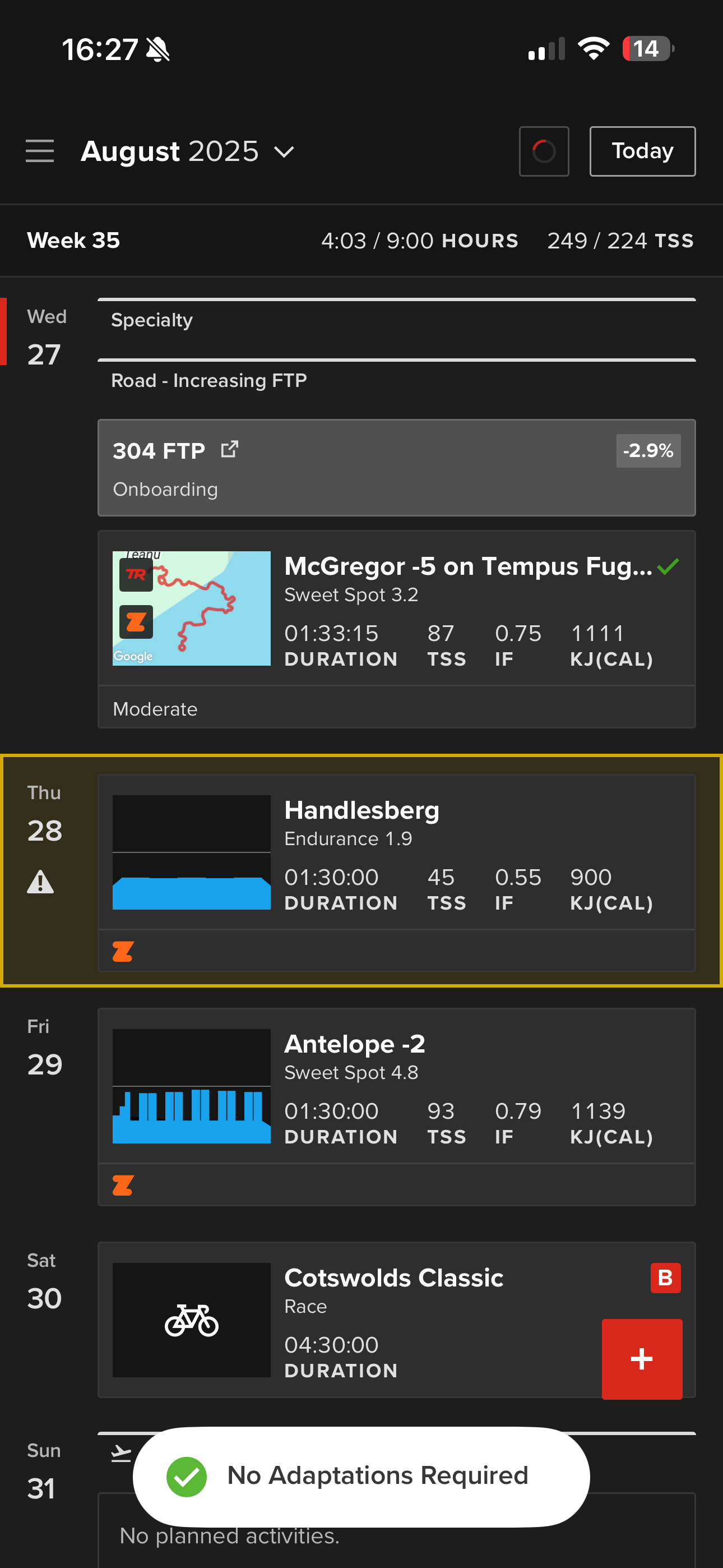

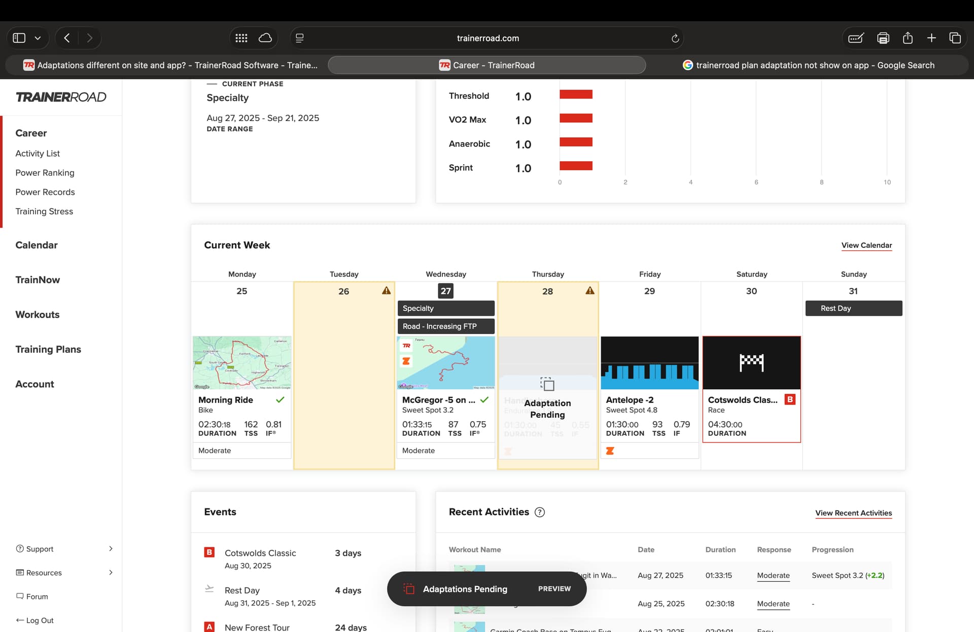

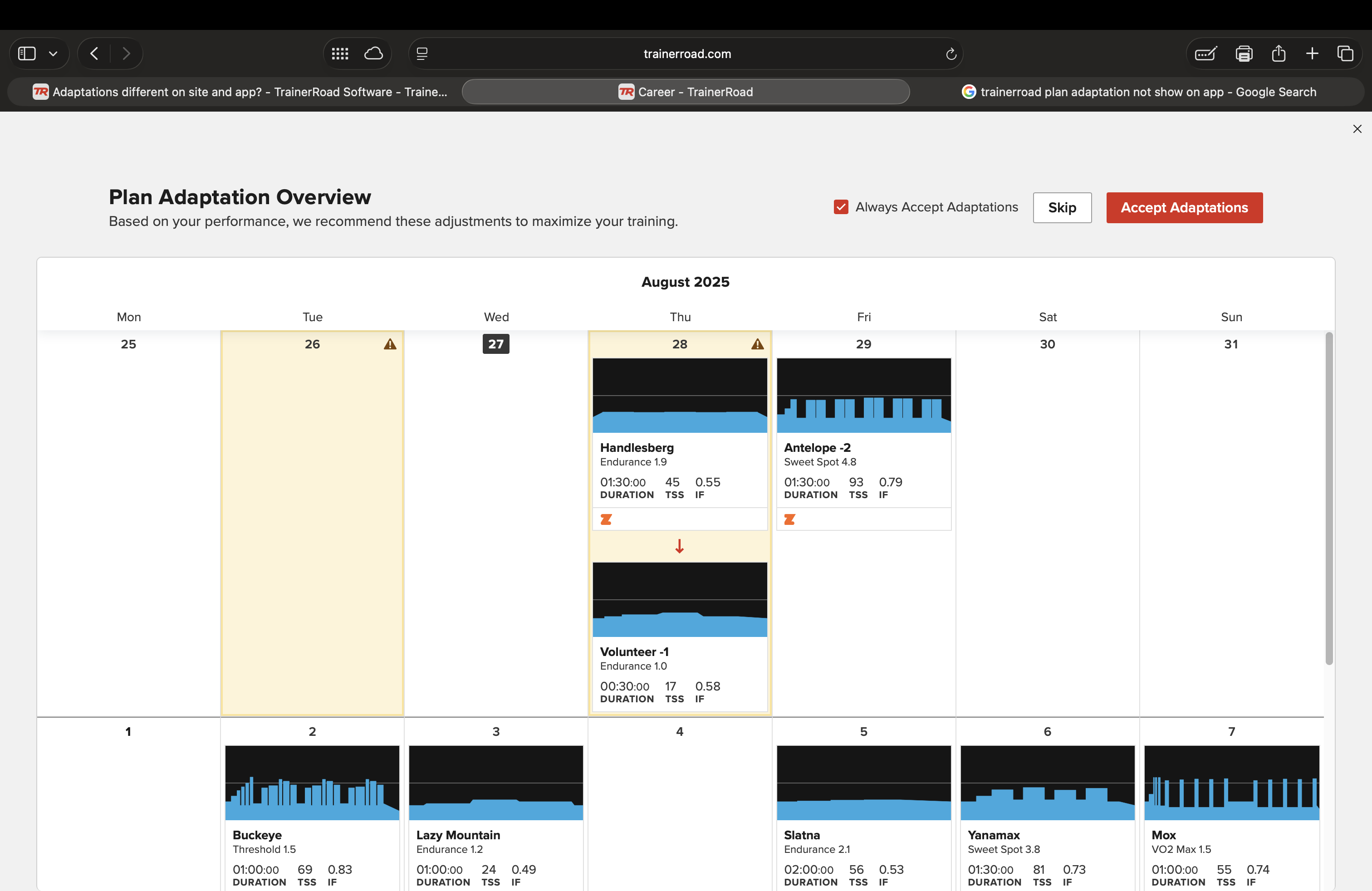

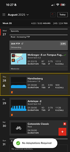

I’ve just signed up for TrainerRoad. Liking it so far, but I seem to have the same issue as mentioned here regarding adaptive changes. The website shows I have adaptions pending, but the apps (iOS & Mac) show “No Adaptions Required”. Am I doing something wrong?

I have tried that on both my iPhone and Mac
I just impersonated you on the web and my mobile device, and I’m seeing Handlesberg for today, and no pending adaptations on either device. :thinking:
Could you send over screenshots of what you’re seeing?
It seems like the app might be running slowly on your end. The web is the best source of truth, so if the app doesn’t reflect what you’re seeing there, you might be having syncing issues with the app.

I don’t think it’s the app being slow. The app updates almost instantly with any other changes I make from another device (such as moving workouts or changing them). It is just the adaptations on the apps that don’t appear to show.
If I had the issue on just one device, you could think it was a problem with the app on that device, or even the device itself. However, the apps on my MacBook and my iPhone do not show any adaptation required when the website does.
