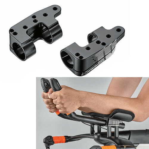

Question…i like to tilted up my aerobars. I saw this one…do i need 10 or 15 degrees, or it depends?

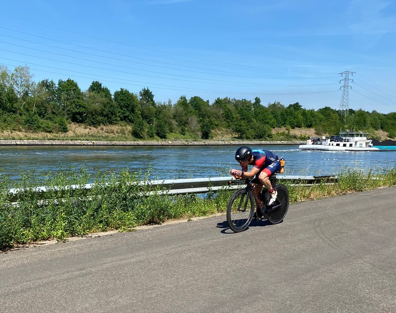

Pic from a middle distance tri:
Pic from an OD duathlon:
So I was doing some 10’ intervals at around 265W (tempo) on Circuit Zolder in Belgium, closed course and I wasn’t drafting or close to any groups and I was averaging 45.2-45.7km/h for those 10’ intervals (about 2 laps on the circuit) where only for one chicane I would sit up a handful of seconds.

It depends on what bar you are mounting it to. And as for the angle, 10, 20, 30 degrees? It depends! I (and I think a lot of riders) are trying to bring hands up close to face, to close up the gap between arms and underneath your body. This is only one approach, but some really fast guys are using it, so it can’t be bad. @Jamie_Berry is using this, above. I guess Jamie is similar to me, with forearms at about 25 or 30 degrees.

I would suggest you do some prototypes with whatever high-rise extensions you have in order to get your fit right (you might do this as part of the fit you are going to have). At that point, you should know what angle you need.
There is a guy in the UK, Jason Swann, who posts on facebook (UK TimeTrialling group) and also on timetriallingforum.co.uk - he makes all sorts of parts exactly for the job you want. I am 100% sure it will be better than aliexpress.

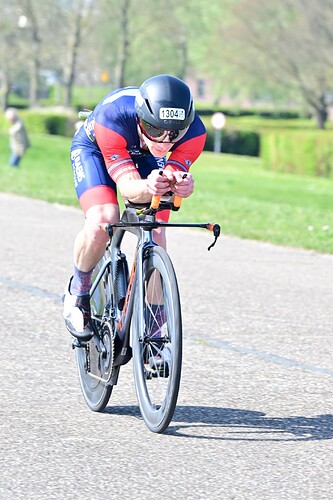

Really solid position…:+1:t2::+1:t2::+1:t2:

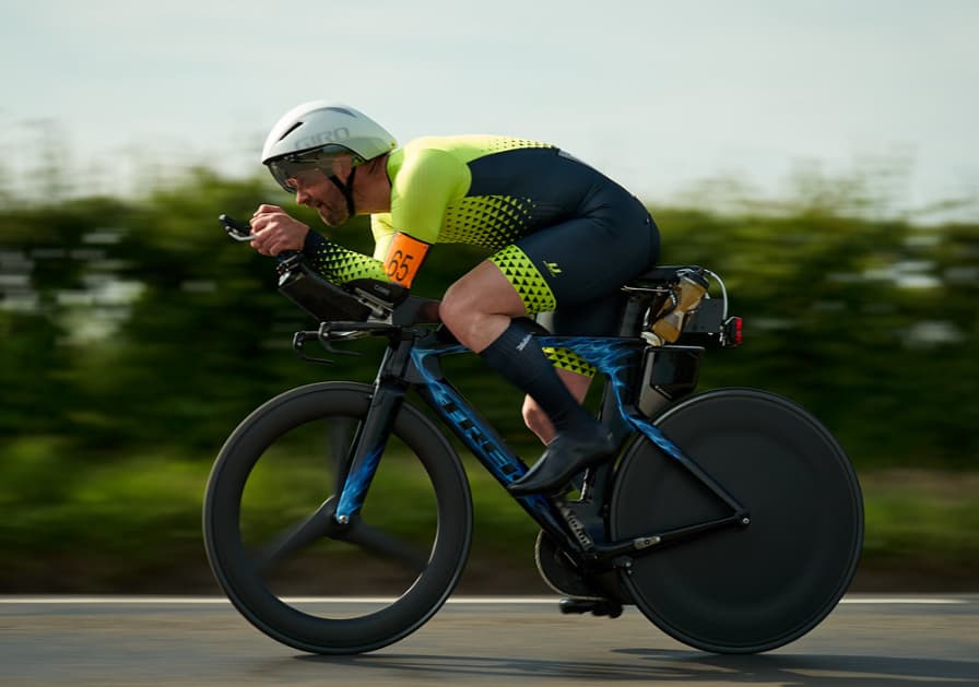

the low hanging fruit for you is to get your head lower. It is still up above your body a fair amount.
I know you said you have moved your elbows forward, but there is still opportunity to move them even more forward. This will allow you to stretch out a bit more, which in turn will lower your front end.
Then, rather than shrug, try collapsing your shoulder blades together. This reduces upper body tension vs. shrugging and will lower your head position.
15* is probably the minimum, but most people can go higher with good results…but it is impossible to know without testing which is “best”.
Thanks, and thanks again. Really appreciate the feedback. I think you are right; and I also think that the aerohead isn’t a brilliant match for me/my position. @Jamie_Berry has much better helmet/back match, and Rohan Dennis/Dan Bigham show how to get the best out of it.

I was already thinking about moving my elbows forward, so its reassuring to hear you mention that too. One thing I have to be careful of is creating stress in the position; my races are generally hours long, and I need to have a position that I can hold for 4h and longer. Do you think this can be achieved? If I move my elbow pads forward, will I feel extra strain, or will it be harder to hold? @Jamie_Berry and @Majoeric - you guys are running your elbow pads well forward, how sustainable do you think it is for a 100m, 12h or more?

It’s definitely a strain on the eyes. I normally creep up slightly to scan ahead. Keep in mind this is pretty much a closed course with two lanes of road at disposal.
Obviously this position is not ideal on a course with obstacles or numerous other riders/vehicles.
