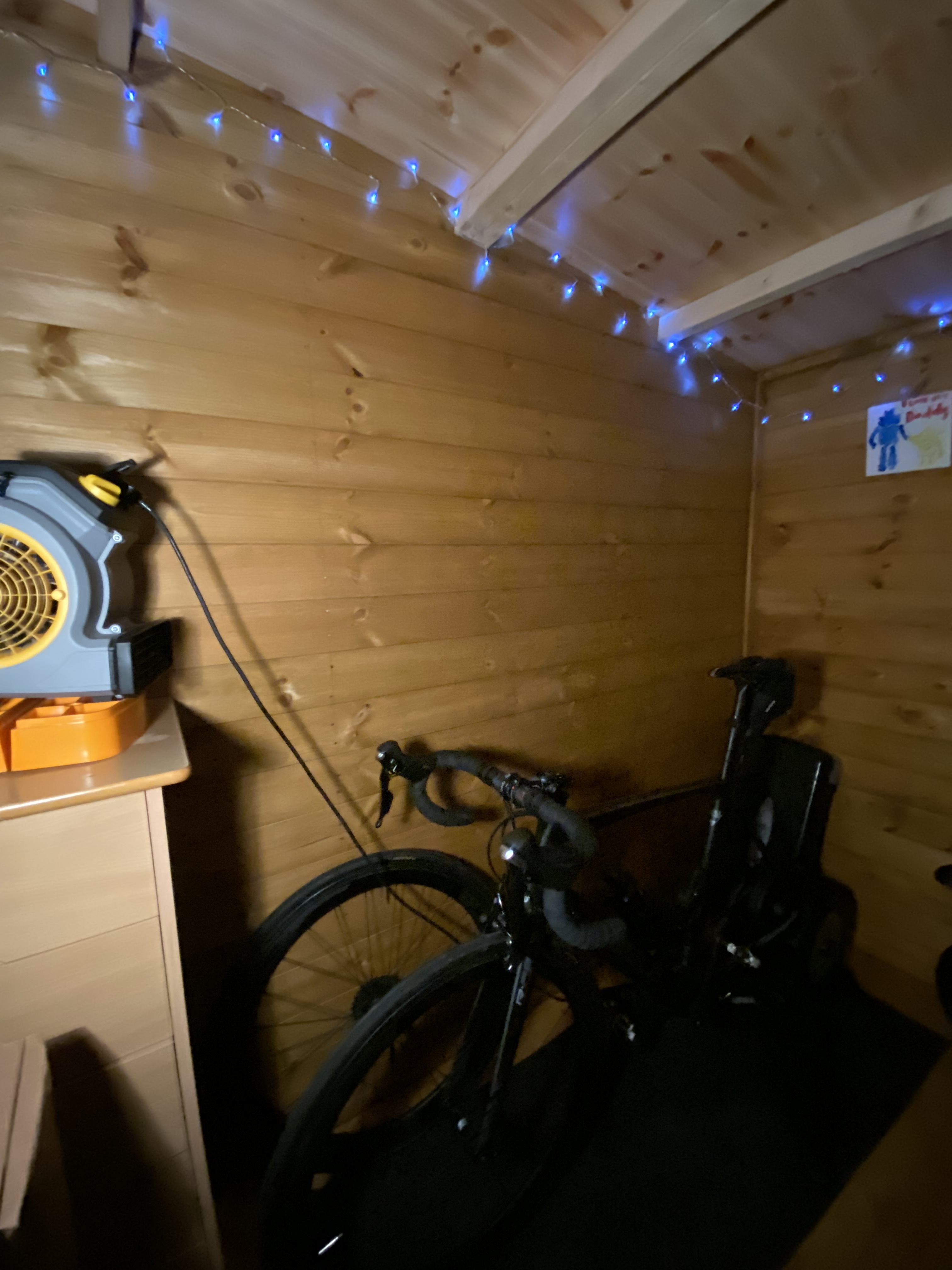

Here’s a little idea of my training setup, since I’ve moved out of the house to train into a dedicated, glorified shed in the garden. All has been well through the summer, besides it feeing like an oven in the sunshine which can be dealt with by use of a fan and wide open doors.
This week however the weather has gone bitterly cold, and I have noticed condensation on the ceiling after I ride. I’ve barely needed the fan on, but have had the door partly open to allow some degree of air flow
I could do with your cheapest/most convenient solutions please, to avoid damage to my new building as the sweat collects above me! Do I varnish/coat the inside? Just wipe it down each time?

I think the best option would be to increase the air flow, so that the condensation does not happen any more. I am not able to tell what would be the best way to do that.
Improve ventilation and or buy a condensing dehumidifier to run in there. Open the door all the way and use the fan to pull in fresh air.
I have a ‘shed’ gym although it’s OSB lined and insulated with 25mm polystyrene sheets, I added some adjustable vents that slide open/shut. I usually leave them open a crack and have the door open while I’m training. I also have a 6ft thermostatic tube radiator that keeps the inside from going below 8C. No condensation issues after several years.
Usually sheds are draughty enough to not need vents though - is the moisture there the following day?
I’d agree with this, get the door open more and see if that stops the condensation. If you’re still getting issues run a dehumidifier
I train in our conservatory and with the door closed condensation quickly builds up even when just noodling around on a Z2 ride, with the door open there’s no sign of condensation at all
As others said, the condensation issue is ventilation issue. Google some YouTube about attic ventilation. Those principles are the same. Essentially, the attic must have adequate ventilation, otherwise you risk mold due to the temp from inside the house leaking into the cold attic and causing condensation.
Maybe I’ll try moving the setup around then, so that the airflow directs around to the door and keep it further open! Failing that, maybe a dehumidifier. I’ve only had it a few months so yet to find out how it truly behaves over time
