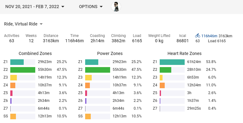

Then i proceeded with 8 weeks of training with 1 vo2max session, 1 OU or SS session (ss progression) and the rest all easy endurance riding per week, averaging at about 11 / 12 hours total work on the bike. Finished the block with 2x50 minutes of sweet spot and felt great. It’s my first year that i really focused a lot of time on Z2 and with succes. I’m now able to hold 230/240 watts and still can keep a conversation :).

I think I’ve had a decent endurance block.
What do you call a decent aerobic block? duration (per week?). Z2 or Z3 or SST work?

There’s endurance work in there, but no idea if there was an endurance block within it or not. Info in the quote above suggests not.
What I meant was, have you done a specific, controlled endurance block (i.e., 6 weeks) where you’ve ridden high volume, at low(ish) intensity?
If not, you’ll probably see some gains by doing one before progressing onto the traditional ‘V02 Max’ training block you’ve posted.

No. Not a dedicated endurance block. The weather still sucks here so i have to do most of the rides indoor, and i cannot get more that 3 tot 3.5 hours in on the trainer. So I’m not sure if the timing for a dedicated endurance block is that good now.
Yes, it’s a struggle. However, 3-3.5h inside is an awesome sessions (in terms of training load).
