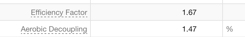

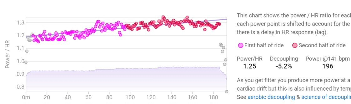

This is from a 3:20 ride at 0.72 IF, or 3.6 w/kg

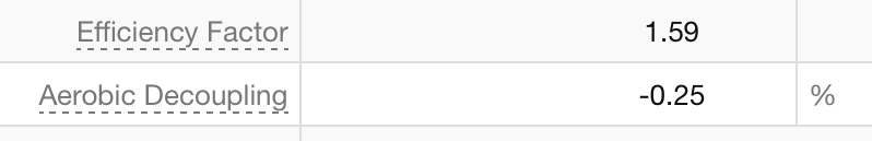

This is from a 4:15 ride at the same IF and w/kg three days later
Clearly my limit is somewhere in the 3.5-4 hour range right now ![]()
Orā¦things change every day and maybe I was still recovering from driving 1200 miles in the two days between the two rides ![]()

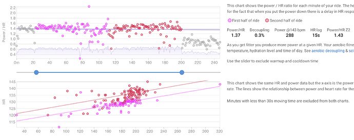

ok, nothing long in the last month except for Saturday without good clean data, but this one from December is pretty close
Roughly 3 hours right now, havenāt tried to push it out the past 30 days. How did Intervals estimate 288W at 143bpm?! Thats ridiculous. More like 160-165bpm in the 2nd half of a 20+ minute effort.
