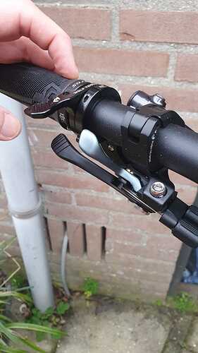

Is this your actual picture? Or a stock one from Wolftooth?
I have the 2022 scott with the twinloc + the barcentric remote for the dropper, as the 3 lever twinloc is not available for months.
I did here some scott person say on a youtube video that the dropper lever could also be attached to an existing 2022 twinloc dual lever… maybe I’ll switch when that is available…
The twinloc / barcentric combination is working for now, but currently I have the cable exit above the brake, forcing the dropper lever to be quite high, but it clears the throw of the lockout lever. When I switch the dropper exit below the brake, the dropper lever is much lower, but it will interfere with the lockout lever… so i switched back to the old position.
I’ll have to see if I can play with the lockout position a bit more (I think it’s already max inside, but maybe I can compromise the lockout position a bit more in favor of the dropper lever…
Did you try adjusting the tiny screw on the side of the barcentric? This àdjust the lever position relative to the cable position. I have the cable exit above my brake as well and this helped nail down the position.
yes, I tried the outer limits for both cable positions, ( i made a mistake though, I have the exit below the brake, this is forcing the lever quite far up, but below it forces the lever down so it interferes with the lockout).

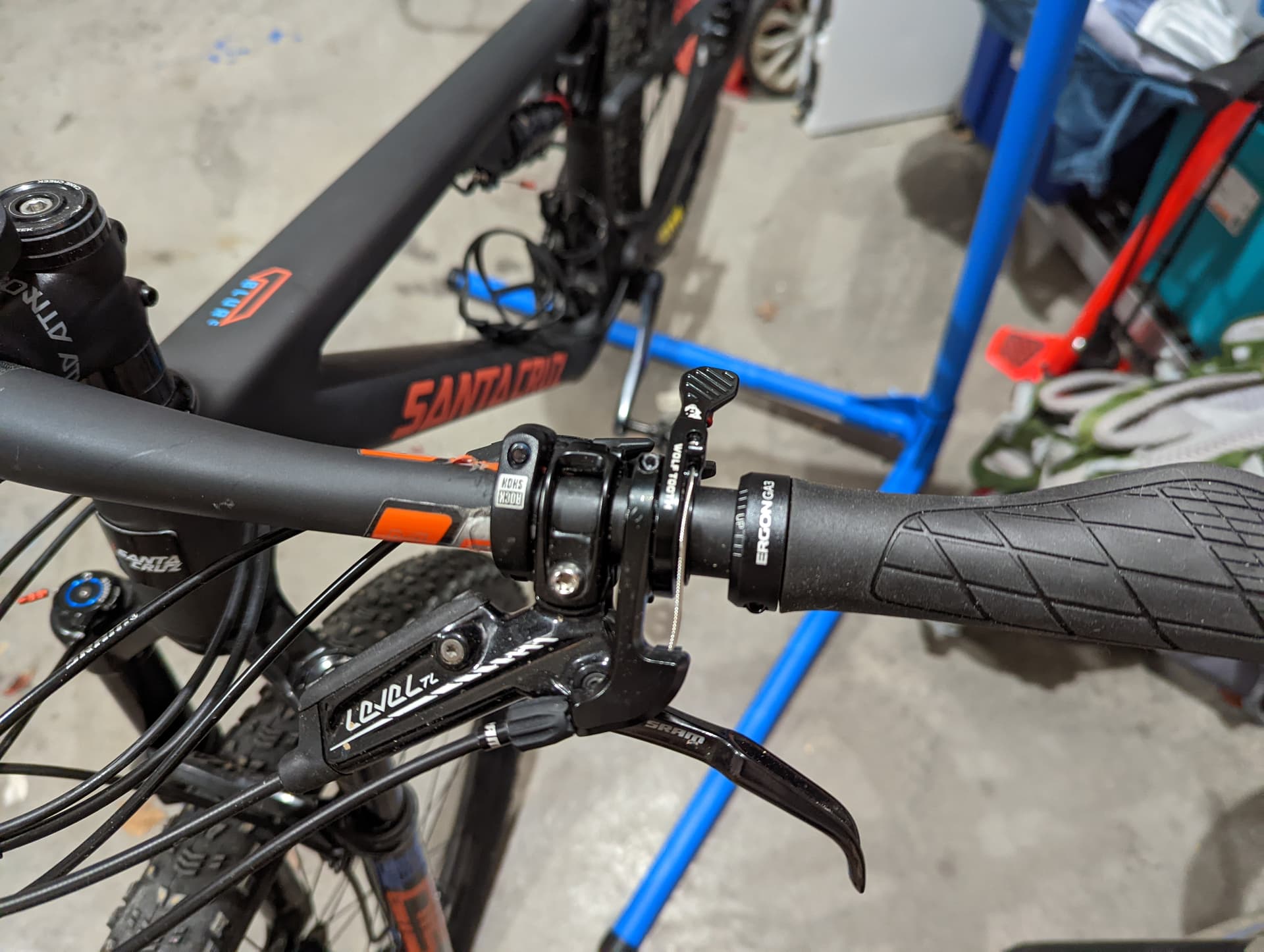

Do you have a picture of yours?
Here’s my actual setup.
ah, ok, this is another (more compact) lockout lever + its way more inboard (on it’s own clamp).
The scott 2022 twinloc lever is a bit longer and has an ispec EV mount to the XT brake (at least in my case). This limits the possibilties quite a bit
