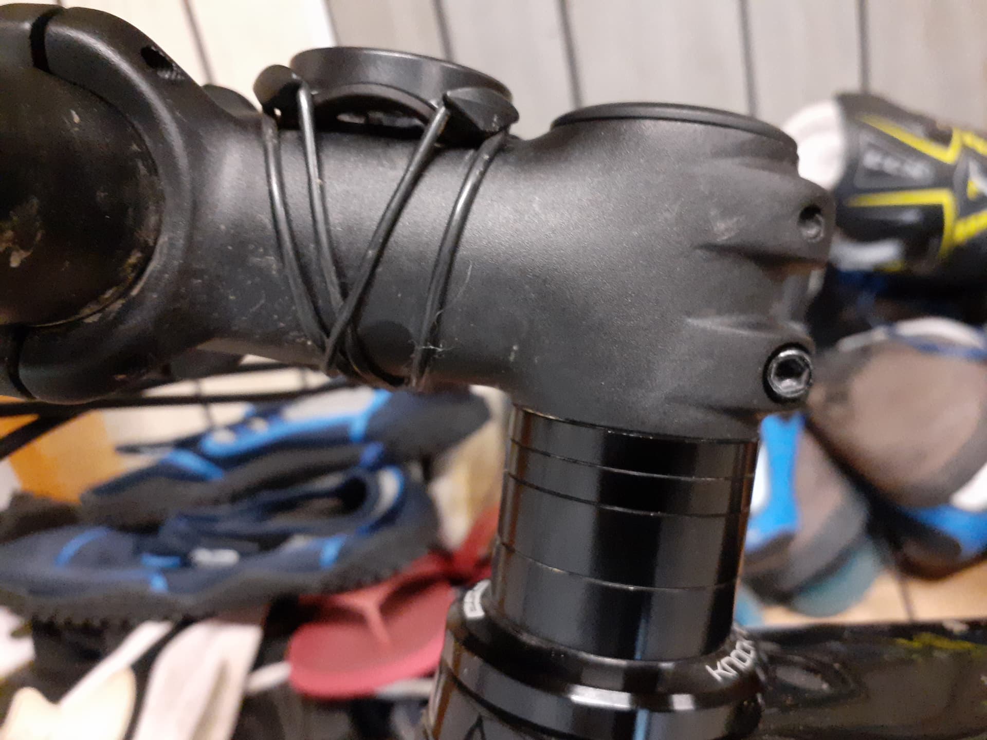

Since getting the Supercaliber, I’ve taken the spacers out from under my stem, but by Enve stem still has some rise. I’ve found the bike handles better in a more aggressive position and it also helps me get a little more aero for the longer endurance races.

@FactoryMatt the bike is a 9.7, all stock other than me swapping my slashed X2 rear for an X4… so thinking the stem is the 80mm. For spacers… I’ll attach a picture.
