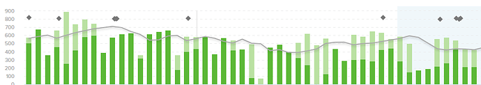

Started my base work in September and wrapped up SSB HV and General Build HV with nearly 100% plan compliance. Didn’t see any significant FTP gains as I started with a ramp test assessment of 359 and progressed to 362 over the course of these plans. Didn’t see any further gains during Rolling Road Race HV which I also completed with near 100% compliance.
Overall failed to complete the intervals in six workouts across all three plans and missed zero due to scheduling or illness.
Frustrating to have plateaued my FTP during this build to my initial A race. I need to consider something different for next season to see if I can break through the plateau. I have previously (three years ago) been able to push my FTP up to the mid 370’s but either age or lack of training variance have seen me get stuck in the 360s the last couple of seasons.

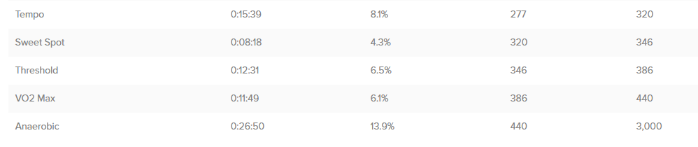

Looking back through my calendar since the beginning of may, and excluding races, I’ve done: 14 VO2 workouts and 13 threshold workouts
If you include races it gets a bit stickier since those have a pretty decent amount of VO2 work in them - which is why I tend to train that less during the season. Looking at a few random races below
I think you do have a point though - my off season training has been more focused on general growth than specific shorter duration stuff.
