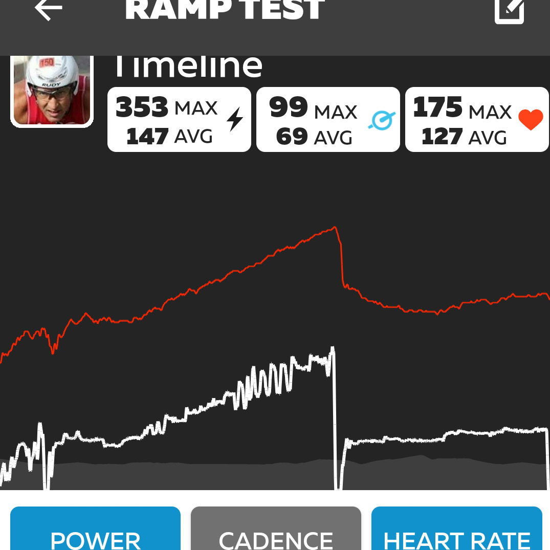

I did the Zwift test in an erg rollers and the results look far from ideal.
The main problem came from using Zwift’s powermatch.
At a certain moment in the test, when the power went up 20w the resistance of the roller decreased like 50w at first and then overcompensated.
This made the test quite erratic and difficult so I guess that I could have reached a higher power even with the added cognitive load that come from the rollers vs a trainer.
This is the first time I had problems with their powermatch.
I could have done the test using the power measured in the roller but the FTP estimate would be completely context dependant and probably useless in a outdoor situation.
So, for me it gets a C-
I will not set training zones based on that figure.
