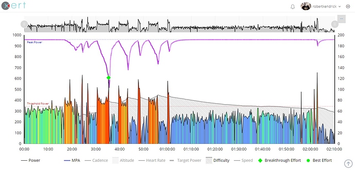

Xert was telling me I had a 325w FTP, which I knew was low based on HR and watts for all the sub-maximal riding I’d been doing. After one good fartlek session with some full-gas 3-5min efforts, each one capped off with the best sprint I could manage, it was up to 345w, which matched up perfectly with the watt/HR I’d seen at lower intensities.
Like any other modelling, Xert works really well when you give it enough data, and the right kind of data.
I had the opposite experience! It was telling me my TP was 337W, and I didn’t believe it was that high until I did a fully commited ride using MPA as a pacing strategy. It was spot on.
No, it doesn’t use 20 min power to calculate TP. It uses all the data it has, but needs some maximum efforts to keep it up to date. There are workouts on the Xert designed to push you to a breakthough to get it up to date. They are awful!!!
It uses max efforts of any duration. the key is that it has to be a max effort.
here is my monday feb 17 ride – the ā€œbreakthroughā€ came after I flogged myself at 400w for 5min, and then did an all-I-had-left :10 sprint to reach MPA (Maximum power available).
I know from 20 years of PM use that whatever I’m doing at a HR of 123 day in, day out is ~75% of FTP. 260w@123 bpm matches up well with that 345FTP.
Give it the max, and the modelling works. It gets tricky when you’re no longer doing max efforts.
