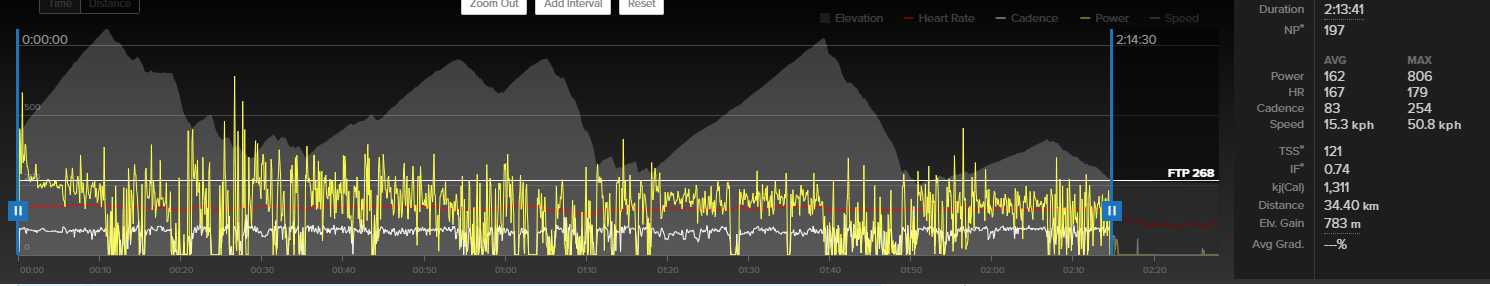

Anyone care to share a similar critique on a gravel race I did over the weekend? I feel like I spent way too much time anaerobic. The roads were in very poor condition with thick mud, ruts and some ice/packed snow. I started the garmin early, and it looks like the time not moving factored into the average data.
I checked other gravel races from last year and the profiles look very similar.

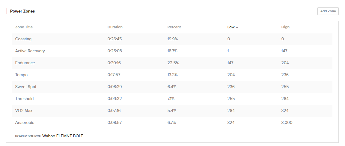

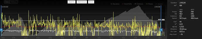

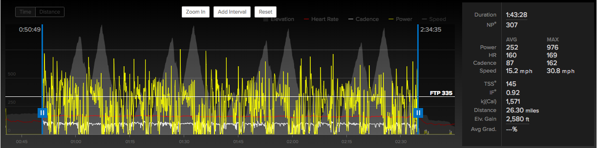

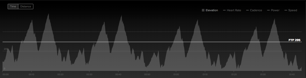

Here are my zones, elevation profile and power output for Bonelli (a notoriously punchy course with steep climbs):
Bonelli Zones
Bonelli Elevation Profile
Bonelli Power Output

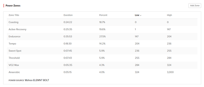

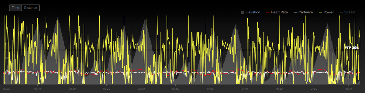

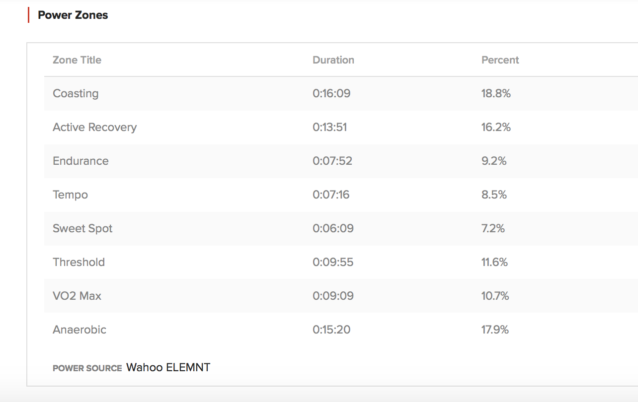

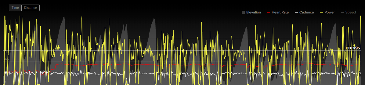

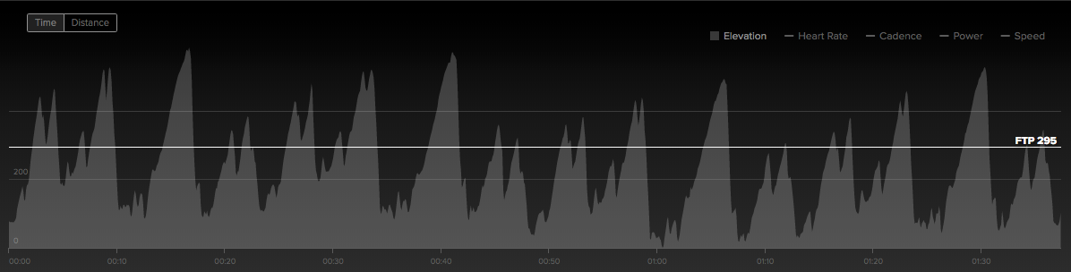

And the same for Vail Lake (a course with a more steady profile, punctuated by punchy rollers):
Vail Lake Zones
Vail Lake Elevation Profile
Vail Lake Power Output
You can see that power output and zone distribution is not directly tied to the course. IMO, significant variables are: course profile, pacing, group tactics, current fitness, and freshness.

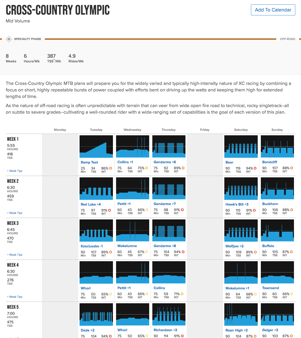

That said, an end-weighted power profile is very common in XCO racing. That’s why you’ll see our XCO plans focusing on these types of efforts.
That said, you can still race some XCO events with a relatively steady power profile. It really comes down to if you have enough fitness to choose how you pace the race. If you are strong enough that the climbs on the course and the pace of the other racers don’t push you too far past your threshold, then you can “smooth things out” to a certain extent.
When you look at XCM races from top level pros, it is surprising how steady they keep their effort. Granted, they can do that since their threshold is so high and their power-to-weight ratio is so favorable, but it is different than what you see with many amateurs. It’s also worth noting that this “smooth pacing” by pros in XCM events is intentional because they know it is a more sustainable approach than trying to punch max watts out of every turn and on every climb. Those rules change when it is a ~90 minute XCO race though. All bets are off in that case.
The last thing I want to point out is you don’t just want to train for exactly what you anticipate you’ll experience on race day. During the Specialty Phase, specific training is key and should be your focus, but leading up to that, I personally prefer to build a more versatile power profile from which I can specialize later on.
Currently, my ideal build up for XCO racing is SSB > General Build > XCO.

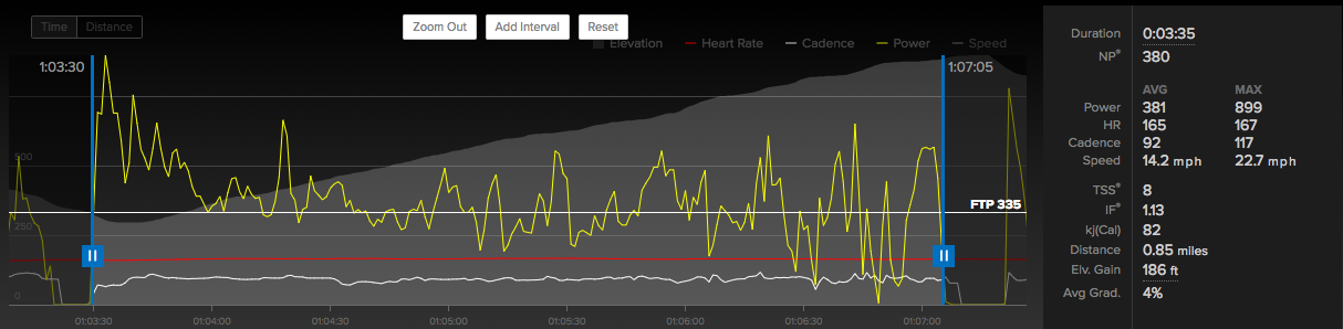

For comparison, you can see my race numbers from Vail where I raced against @Jonathan This race was brutal for me because I dropped my chain early on the first lap and found myself dead last. I put in a big effort (roughly 115% for 3.5min) on the main fireroad climb and it really crushed me for the rest of the race. At the start of the climb I saw a big group ahead and the idea was to latch on for a bit of a draft so I basically went full gas to get to them, but then I just kept jumping on it to get up to the next rider on the road. I would have been much better off just going threshold and working my way through the pack over a couple laps rather than burring myself like that. There’s really no excuse because I had the power numbers on my head unit, the clear lesson was to stay with your limits, especially when there’s still 75 minutes of racing ahead.
Here’s the fireroad effort:
Here’s the race effort:

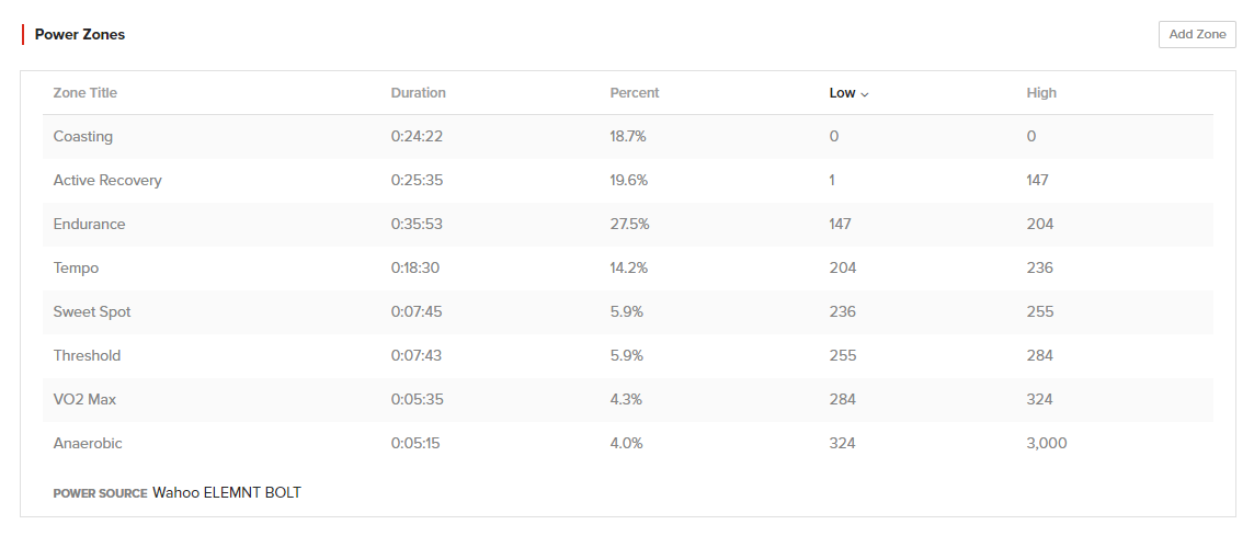

Here’s the race distribution:
I’ll chime in as well with my distribution from Vail. I’m in Cat 2 and frankly my technical and race skills are lacking compared to the Cat 1 folks and it shows. My car has a pretty good engine, but the driver sucks!
I definitely felt like I could have gone harder at the end of the race (although I dropped my bottle after the first lap and tried to conserve a bit of energy during Lap 2).
