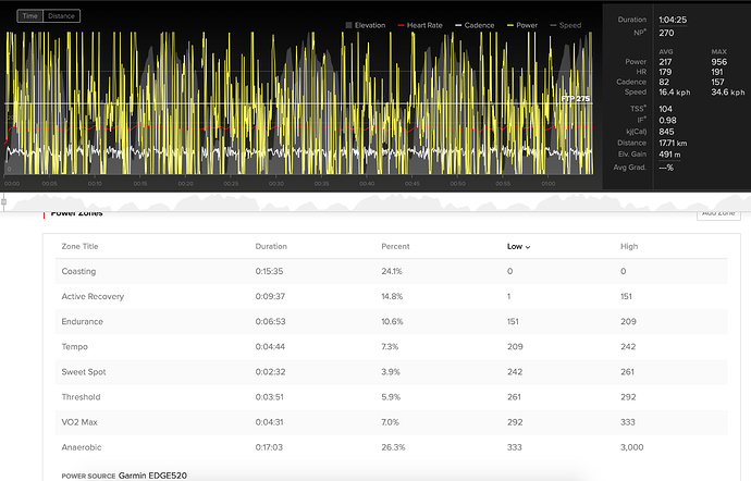

Regarding the OP and MTB/XC-racing Zone Distribution, I did a race simulation this past weekend (with a full race warm up) on a trail that is in my XCO race series. I rode two laps of 100% punchy twisting singletrack. My first lap was 30:22 and my second lap was 30:44, so a pretty consistent effort. I would say I put in a pretty hard effort (95%), but not a full all out race effort. I took 2nd place (Cat 2) last year at this 1 lap race (TT style XCO race) with a lap time of 32:04. Side note, my second lap this weekend was 1:20 faster than my only lap on last years race day (thank you TR :grinning:).
I have a power meter on my MTB now, so I’m finally able to analyze my outdoor and trail efforts. I was very surprised by my effort zones. It appears I was mostly either at endurance and below or in V02 Max/Anaerobic. A quite on or off effort with not a whole lot near the middle zones. Previously I would have thought my efforts (50%) were much more steady state (threshold), interesting to see I was way off :thinking:. I may need to adjust my calendar to Short Power Build instead of General Build.

Had my season premiere yesterday racing. Went fine I guess. My NP is way above what it was last year and I improved my laptimes by 18%.

cool thing from that article… most of the time at and above Max aerobic power were only 10s durations or less.
sometimes when we look at off road power data it can get a little bit discouraging to see what looks like a “low” power number, but it would probably be good to see how many times you went above a specific Watt value for 10-15 sec.
I have an XCO Race this weekend. I will load the file in the DCR Analyzer and play with power smoothing to see if I can tease out those 10-20 second efforts to see their frequency.

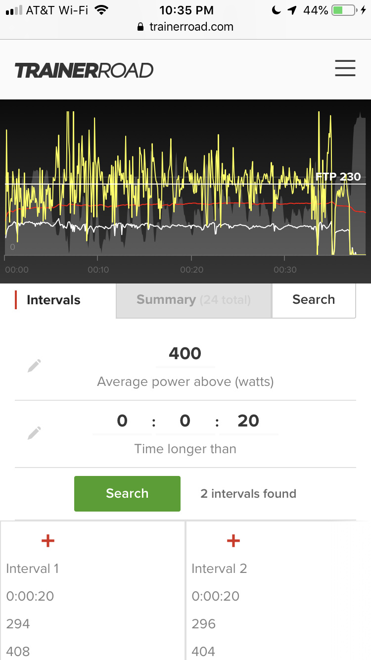

Use the TR search for example:

Thanks, I was not aware of that function.
