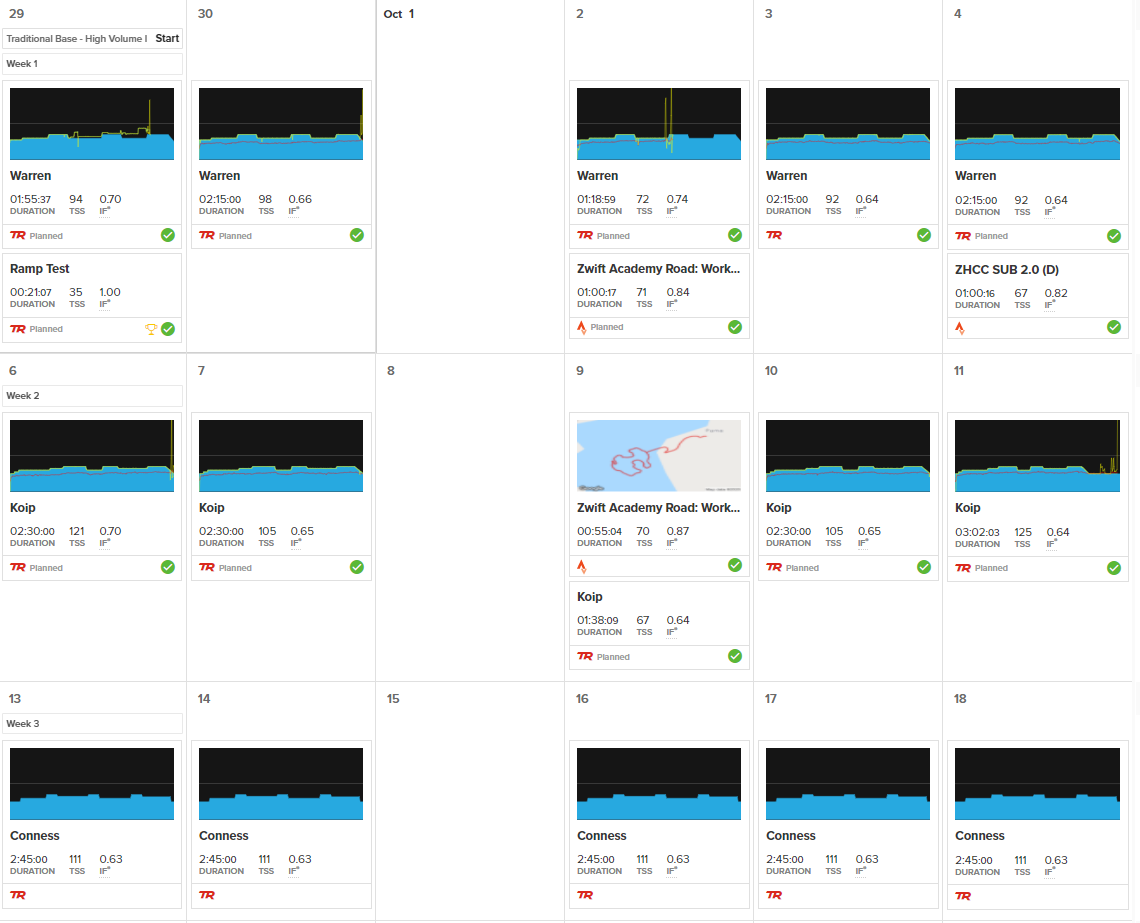

The most important part is and that I have just realized is that I probably didn’t train all muscles in my legs equally because of never using the small ring up front.
When I am in the Big Ring in the front I basically only have to tip the pedal at the high point for it to do another revolution, if that makes any sense. In the Small ring, I have to work the full revolution, therefor I think more muscles are involved or at least differently. Last year I only did Big ring like you, and on the flats, it feels very similar and also Power Numbers are similar to my trainer rides. But boy when i had to go uphill I knew pretty quick that this feels totally different than on the trainer. Watts are Watts you can say but when i go uphill this 9% gradient and I am in my lightest gear I pretty much get exactly that same feeling.
Where I life we pretty much have only uphill and some steep gradients, I like to be able to have the same power I have on the flats also uphill
So my idea is to replicate in the training what I will be facing outside and where I like to improve the most. Also if I then do a Zwift race on the flats it feels like cheating :wink:
I now have done already +2 weeks of my long indoor Base Rides all around 2h+, almost all in the small ring front back big combo. And it already feels a lot better and more natural and less wrong so to say.
Let me summarize again
Basically, I hope I will develop underdeveloped muscles from only Big ring indoor training last year. That’s my idea, also one thing is clear doing longer rides will make 1h rides feel really short and that is also something I was interested in, getting used to long indoor sessions. I think that I already did.
The next week will be long 4 maybe 5 2:45h rides I am not sure if I can finish that off. Probably will do a Zwift ride on Sunday if i do it at all.

Thanks @Ridill. I’m inching ever closer towards dropping down to the small ring. I’ll just have to accept that it’s going to feel strange for a while. After 4 winters of training indoors, I’m struggling to take the leap and change my setup. My big concern is that if the easy sessions feel harder, then what are the hard sessions going to feel like! Perhaps I’m overthinking things.
My local terrain is also full of ups and downs, with very little in the way of flat roads, so I know that ERG mode in the small ring is going to be more in line with my outdoor riding, so it should be more beneficial. I’ve been riding purely Z2 sessions for the last 8 weeks (4 more weeks planned, then will be adding in some tempo work), and with hindsight, wish I’d made the switch when I started this particular phase.

I know what you mean, I think during Zone 2 it is perfect to do this. I just recommend starting the Session like this. You can always say you do the first half in the small ring and then move to the big ring. You still will benefit and mentally it will be something to look forward to. But I bet you will get to the point where you say I can/like to finish it also in the small ring because you got used to it.
Also the days you do use the big ring for one of your later harder sessions it will be like you have a extra gear so to speak :wink:
I am also sure the big ring will always feel better easier for me , and it is not like we are not allowed to ride in it, it is just that we can’t always use it. And one of my limiters is the small ring feeling and not the big one. So dedicating a few weeks to this seems like a no-brainer especially knowing how fast gains can come if you training something you may did neglected in the past.
And yeah for comparison reason I will to my Ramp test the same way I always did. if Necessary i will adjust my ftp down but i will not test different
