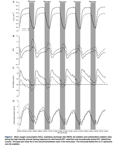

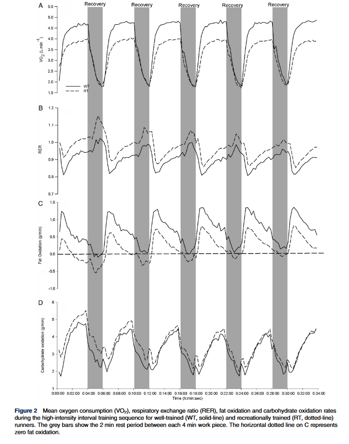

So if it is bad to do intensity early in ride because it would shut down fatox for 20-30min, why is fat ox happening after the first 4min interval. All the remainder intervals should be carbs only. But no, the first 2min of each 4min interval runs on fat!

it takes 4-5min after an all-out effort to restore fat ox. And even to an elevated fat ox level. This is why many coaches prescribe this priming efforts for time crunched athletes. Elevated fat ox is about the level you would see when doing fasted training.

I would expect this due to the increased catecholamines associated with the max efforts to increase lipolysis. Do you have a ref or source for the german graphs?
What we’ve done so far is show that ISM’s “workout order” is based on something incorrect. So to keep my opinion out of it for now, the question for everyone reading is: did it matter in the first place? And if it does, what could be done better?
