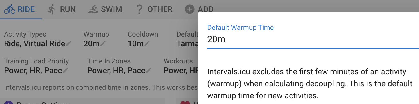

You may want to play around with these Intervals settings:

Where I found that doing 60% FTP from the start, my heart rate takes 20-30 minutes to stabilize. So my rule of thumb for decoupling is to toss out the first 30 minutes of any workout, and that set end time based on the workout (outside it varies due to traffic coming back into town).
(I don’t use Intervals much, and haven’t tweaked my default warmup time)

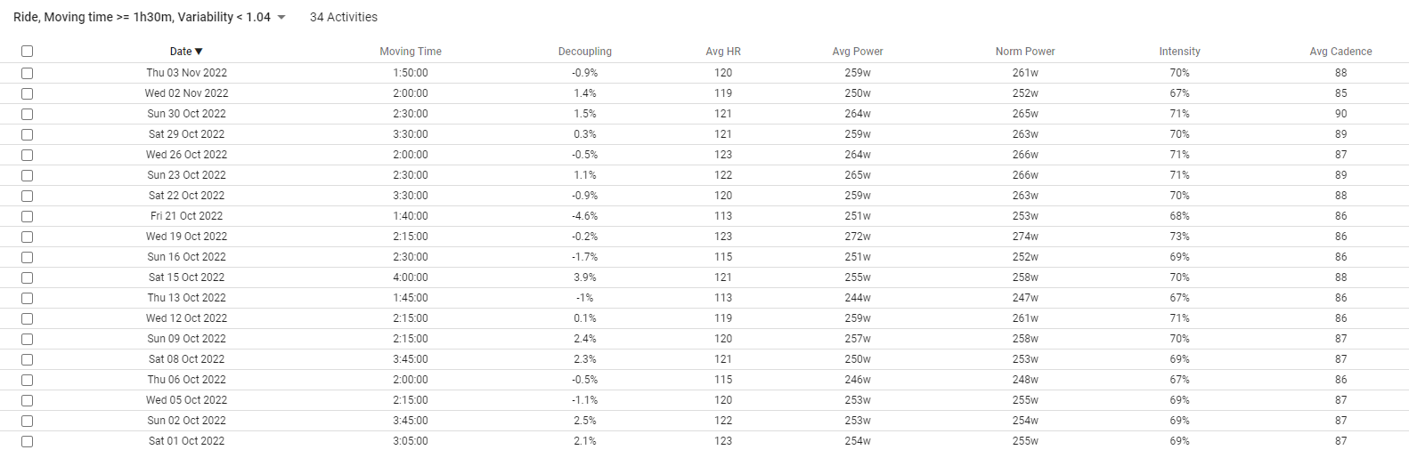

I honestly stopped looking at decoupling with such a fine eye a while back - but below is a similar view of the rides I’ve done indoors with a low VI over the last month - I’ve included shorter durations so you can see the variations I see on those, as well as the longer ones

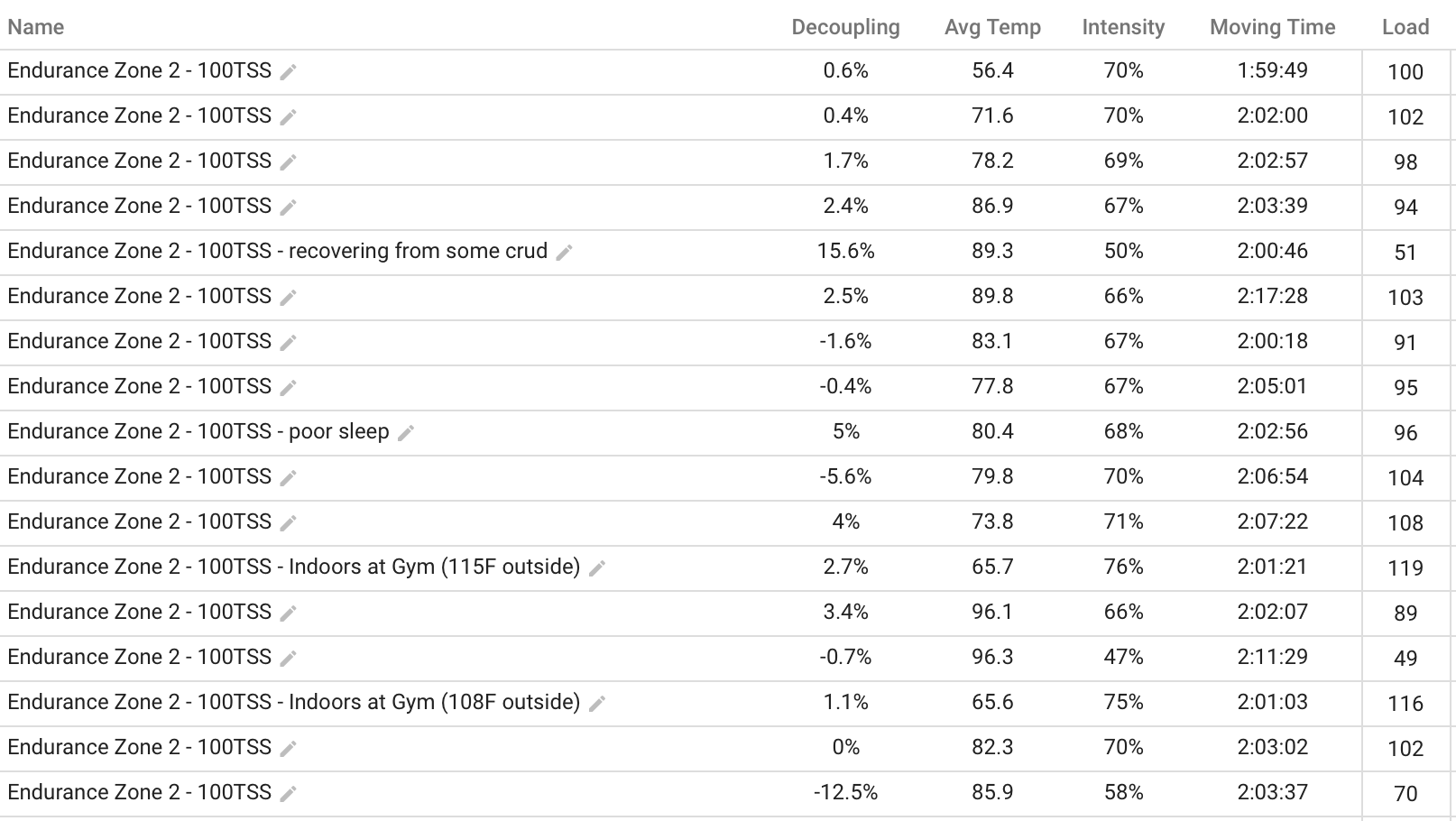

Last three months of my “Endurance Zone 2 - 100TSS” rides, using Intervals-icu defaults(?) of 20-min warmup and 10-min cooldown which isn’t the best for my rides but good enough for this discussion:
all outdoors on flat terrain, except for 2 in the gym during heat waves. One route takes 18 minutes before getting out of the city, another route is 10 minutes, and another is about 15 minutes.
Some pretty large swings in average temperatures. I’m fully heat adapted by mid-late July, and the one on the bottom is beginning of August.
Anything below 3-4% is NO decoupling to my eyes. So when I look at my chart above there are only two outliers - 15.6% while recovering from crud, and 5% after poor sleep. The rest I’ll wave my hands and claim no decoupling, nothing to see. Hope that helps.

“Whole ride” decoupling is flat out wrong in my opinion. There is a reason Intervals-icu added the warmup and cooldown setting.
But yes, if you use incorrectly use Intervals-icu (or any other tool), then I agree.
