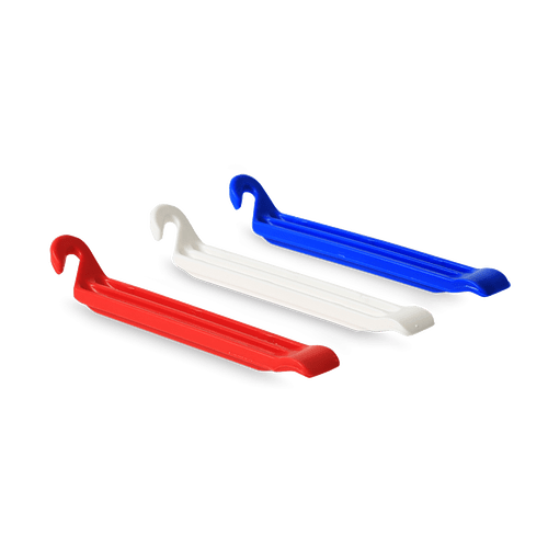

I have bad arthritis in both thumb joints (22 years of beating on patients in a physical therapy setting). I love GP 4/5k’s, but had the same problem mounting/removing the TL’s. I found a combination of Silca’s tire levers (super thin metal material) for getting under the bead, plus Schwalbe’s levers (sort of a clothes pin function to hold the tire on for that last 10 inches or so of struggle makes the task doable
