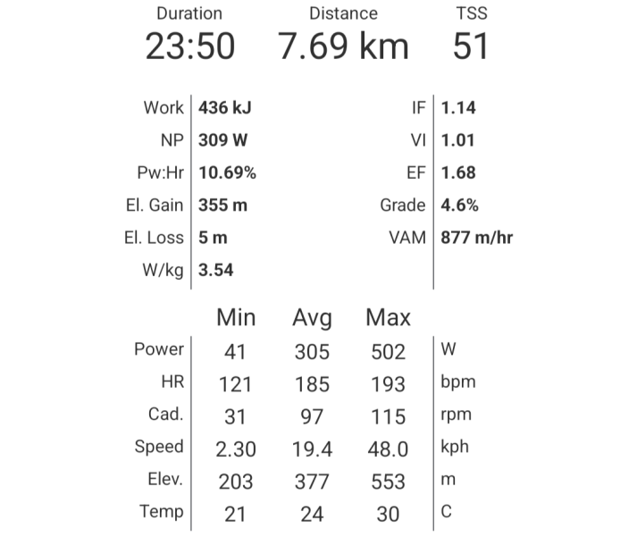

The following was shared with me by EC coach and donut enthusiast Rory Porteous, who is currently training in Mallorca.

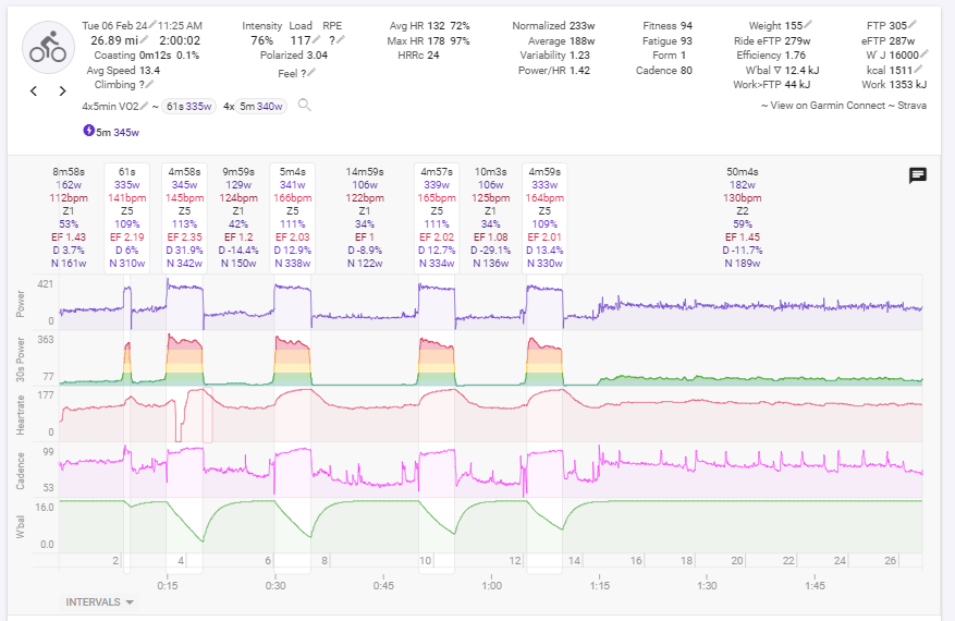

the first 13mins, according to him, was done at 121%. He also tested FTP 4 days ago and his ftp is 264. Now, this may be an extreme example but it shows that sticking to percentages is really not the way to go when thinking about vo2 work. On the other side of the coin, I struggle with hitting 120% on 3min efforts and my 5min power is around 112% in recent workouts. It took me a long time to come around on this, and I hope by sharing this maybe we can get a few more people off the vo2 % of FTP train

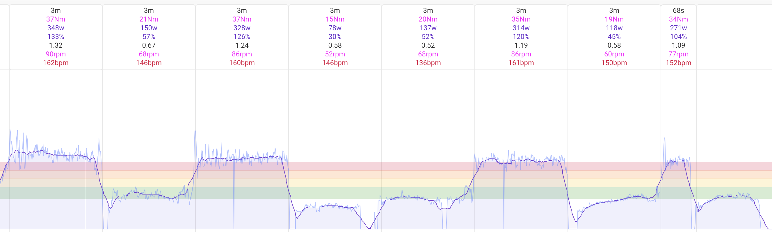

overcooked the first one at 133% ftp, then 126%, then 120%, and on the 4th mentally surrendered to my screaming legs.
One of the first hot days, did those around 10am it was already 82F / 28C. Good times.
Haha my first vo2 workout is almost always a bit off. First interval overly ambitious then just hanging on for as long as I can.
After that though they are dialed in, still feel like death but at least get my target time in.
