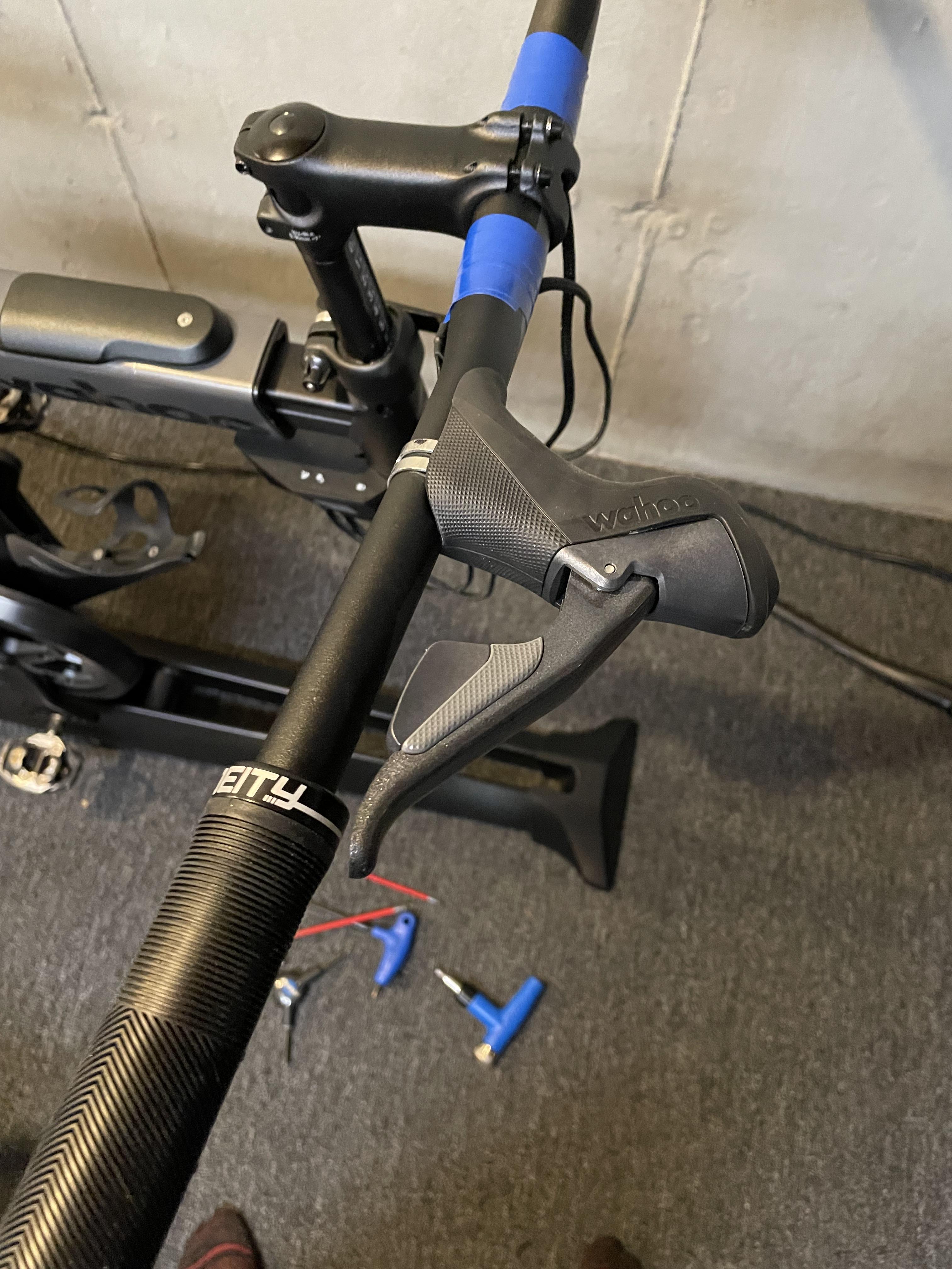

I set up my Kickr bike to mountain bike geo. Works great.
Photo?
If I was buying now I’d go with the Kickr Swift. Got mine at clearance so the price was right. But I don’t use things like the tilt. Heard the Kickr swift is very quiet as well.
How did you get MTB geo on this? I assume bars are at least 740mm wide on MTB.
It has a regular stem so if you wanted you could take off the road bars and put on a flat bar. You would have to figure out what to do with the shifters. If you were only using erg mode, you could just find a spot to have them hang out of the way somewhere while still being connected. If you wanted them close by so you could use them I’m betting you could put them on the flat bar with some shims. It might look a little funny, but it’s work

In terms of the two itself, the bike does have a ton of room for adjustment so even though most of the fit coordinates are based around drop bar fits, unless you are really tall or really short you should be able to set it up with mtb fit coordinates
