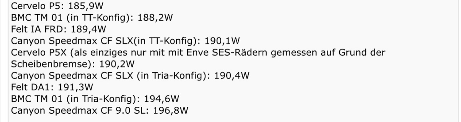

I did quite a lot of research here, and got a few insights, most of which I can share because they are publicly available.
The following tests have been conducted by the same magazine (RennRad) and therefore are at least to some degree comparable. I will however point out the flaws, that might or might not render the results void. It is one of the better indications there are.
So these are the results from 2017 - besides the P5X - all bikes are measured with ZIPP 808 front and rear - the Cervelo is measured with ENVE SES 7.8 Disc, and is the only disc brake bike.
The test is made at 45kph, with a non-pedaling dummy that doesn’t have an upper body (to not make body position relevant).
The two interesting takeaways for me:
The Cervelo P5 (UCI Legal, 2014 model) tests significantly faster, than the P5X (tri specific). Also, the fact that the Tri Specific Speedmax doesn’t test faster than the UCI Legal version is interesting.

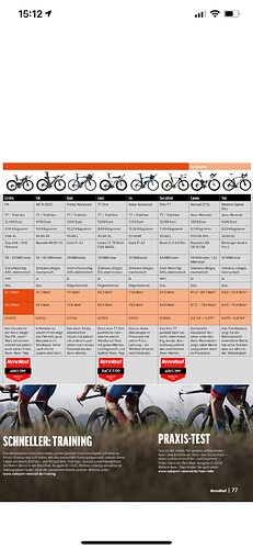

They did a test with different bikes in late 2020 - which is interesting - but the test is protocol is awful.
The test is conducted at 45kph again - however bikes are from completely different price ranges, tested with the wheels pictured, not with standardized wheels, and without any rider/dumm. Kind of pointless.
Still, I am happy to see my Shiv TT perform so well, despite being tested with only 64 mill deep front and rear.
The PX is the fastest bike in the test - with a 404 front, 808 rear. With the PX being very very similar to the P5x, I kind of expect this to be the link between the two tests.
Not perfect by any means, but kind of tells me, that the P5 (2014 - UCI) is likely still among the fastest TT frames around - with its successor deemed as fast/ faster:
Too many cross references to be conclusive, I know. But very much in line with other test results I have seen (and also which have been posted here).
