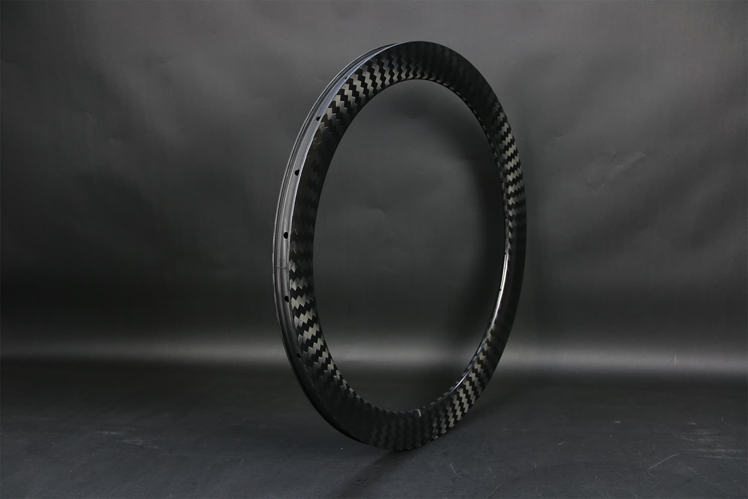

Took a little while, but the rims I’ve ordered from Light Bicycle are shipping soon. They sent over some pics.
A 650b set for my gravel bike, to be used with cushcore XC and 650bx47 Maxxis Ramblers.
and
A 700c road set, tubeless with 28mm GP5000 S TR.
IMG_4660
Looks fantastic!
