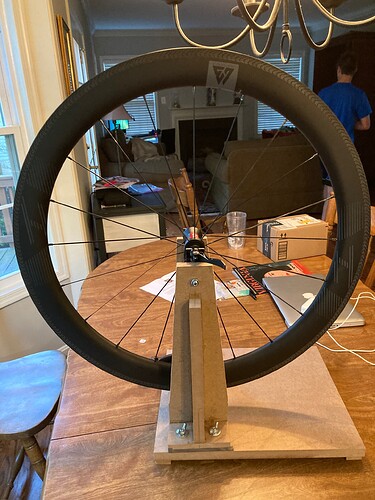

@Pottery great suggestion! LBS gave me an old spoke. I cut it off at the threads and wrapped a little bailing wire around one end for some additional steel for the magnet to grab. Worked like a charm! Wheel is laced. Now I need to true it.
I like your DIY wheel stand! Did you find the plans for that online?
What rim did you go with?
@Mike_M the plans are from Roger Musson’s Professional Guide to Wheel Building. There is a link up above to purchase it.
My dad does wood working and is retired, so I asked him to build it for me. (He also built my Rockit Plate from @mcneese.chad’s plans.)
The rim is a Light Bicycle R55. It is a warranty replacement since the original cracked when I was inflating a tire.
This is a super simple rim to lace since there are no crossed spokes, but I’ve almost got it dialed in. I’m going to let it sit overnight for any residual stresses to settle, then hopefully finish tomorrow.
