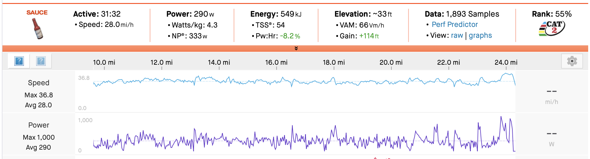

Here is a local drop ride on a fast, flat, and windy course, I can hang on for a bit and then get dropped. Friend’s Strava from this week and last week:
and
pretty consistent week after week, about 330W normalized power for 30-minutes.
My current 30 minute power is 275W. I can do 330W for about 4 minutes. What am I doing wrong? :crazy_face:
HTFU
Be faster.
Kidding of course! That is a pretty brutal pace. I’m pretty strong at my local team rides but 330 Normalized power for 30 minutes is pretty tough. Maybe fully rested? Looks painful.
