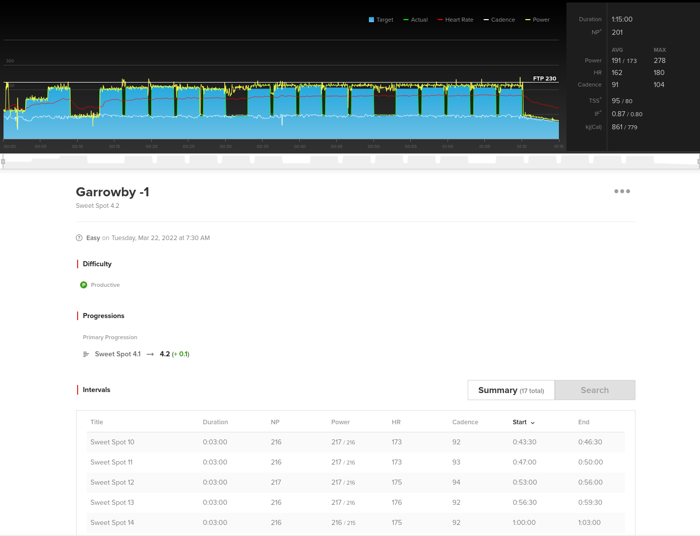

Can someone provide a screenshot that shows this happening in a meaningful way? Below is a ride I did this morning. Garrowby -1. I rode at sweetspot during the rest periods, and the 2nd two sets I rode at 94% of FTP, rather than 88,90, and 92 that was prescribed. I am not surprised that skipping the rests is ignored, but I would expect increasing the level of SS intervals by an average of 4% would. I tried to keep the increases within the SS range so they wouldn’t get ignored by being a ‘threshold’ interval.
Maybe this does work, but I have not seen it in any workouts I have increased the difficult of.
It was rated a 4.2, and I got 4.2 even with the significant increase in interval power.
Are other people getting a PL of greater than the standard workout when increasing the difficulty?

FWIW you rode the recovery intervals “significantly higher” than prescribed, and AT does not currently recognize that per the article.
Right, but I kept those at about sweetspot, so it still should affect a sweetspot workout. I did that part for me, since I was feeling good, rather than really thinking AT would do anything with it.
I was very careful to keep the intervals at 94% of FTP, as I think that’s the upper limit of SS as far as TR is concerned.
I should pick a workout that is easier to adjust - ie a SS workout with all intervals at 88%, then moving to the high end of SS for all intervals should be a detectable and notable difference.

Maybe you are mis-understanding my point - I am trying to determine if this ‘superpass’ feature works or not. I have seen lots of discussion about how it might work, or how people think it works, but I have not seen posted an actual example of it working.
I posted an example of what I think is it not working. I am not expecting a PL for a 55 minute SS effort - that is clearly not advertised as how it works currently. What I was expecting, based on the description in the article, is that it would recognize the the last 10 intervals were done at meaningfully higher intensity than prescribed, and I expected some adjustment based on that. That’s all.
I don’t see the current behavior in the app matching was is described in the article I linked. This is not the only instance where there was no adjustment and I thought there could/should be one. If no-one is getting super-passes, then it’s not worth bringing up with support, as the feature is broken or not implemented, and they have more important things to work on.
