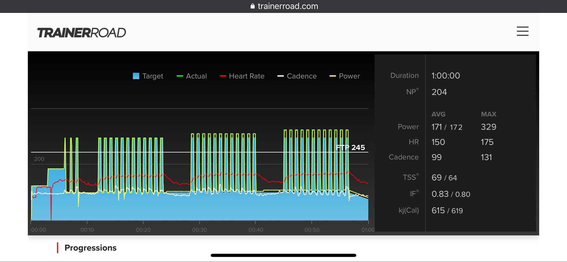

So tonight’s workout was Taylor -2. This was the first vo2 workout of this training block. It felt great. After the first set, I upped the intensity to 105%. After the second set, it was moderately hard so I bumped it to 110%. Finished the workout and rated the workout as hard.
So my question is, what’s better, doing the workout as prescribed and marking it as easy? Or upping the intensity and marking it as hard?
Thanks!
I would have left as is and rated it as easy.
agree with John - AT will likely only look at the workout as planned and you rated it hard (when you didn’t find it that hard).
I would go back and rate it moderate or easy

Taylor is an “easy” VO2 workout. If you know going in it will be easy, I think better to swap out for a harder VO2 workout. Otherwise, just let AT do it’s job and adjust the next workout for you.
I did. It was a stretch workout so I got a bump of 1.6 points to 2.6.
I just looked, doesn’t look I got any bonus points for upping the intensity.
In this situation, I’ll up the intensity as I desire but grade the workout as if I didn’t up the intensity. This allows you to get the workout you want (I don’t always know beforehand that it’ll be easy, otherwise I’d switch workouts as others have said) and still get AT to adapt your future VO2 workouts. This approach has worked for me.
You are doing this for yourself, not for the AI. So just make the workout harder if it is feeling too easy, to get the most out of your training.
Then you apply a little bit of your own Intelligence and for the next workout if the AI didn’t pick up you can do a higher PL, you can pick a harder workout yourself and the AI will soon adjust.
Personally I would do the workout as you did - make it hard enough to get some benefit from it or you’re wasting your time.
BUT, you must rate workouts based on what they would feel like if you DIDN’T CHANGE ANYTHING. AT doesn’t look at the fact you increased intensity, so right now it thinks you found the standard workout hard when you actually found it easy. Go back and change the rating as others have said.

AT, like any coach, has an idea what will be easy or hard for you at a moment in time. If you are given a “hard” workout and rate it easy then AT will ramp up the difficulty of future workouts quicker. Conversely if AT thinks the workout should be easy for you and you rate it hard then it will ease things off.
Also AT isn’t trying to get you to peak fitness now but in time for your target race/event. Just hammering workouts because they aren’t as hard as you think they should be will lead to burn out in a few months’ time. Been there, don’t want to go there again.

If a workout is easier than it should be, or I’m feeling sporty late in a block, I up intensity and rate how I felt on what I did. Then next workout I consider what I did and pick my own alternate rather than the AT progression.

I would refer to the initial workout when rating it in the survey. So out of those two options I would leave the workout as it was and marked “easy” but I dont think there is any problem with you increasing the workout like you did and still marking it easy.
